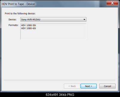

    Hi everybody I want to do some HDV tape printing for fun using my Sony HVR-M15AU deck which is capable of recording progressive, What software is capable of printing progressive ? I tried Sony Vegas and I only have the option to print 1080 60i or 50i.

    If you look at page 15 of the PDF file, only 60i and 50i are allowed to be printed to tape and that's exactly what I'm getting.

    See attached picture:

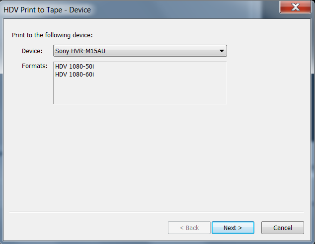

  11. Then print it interlaced. Load a clip into ReStream, change flag to interlaced , save it, load it into Vegas and print it to tape.
    Are you sure about that, capturing is quite a hassle, not really a way to go today. Your capturing device might be rust and dust later on.
    Just remember, you have to the opposite after capturing it back. Certain version of Vegas would even smart render 30p HDV, Vegas 8.0c, later versions perhaps could not do it and only interlace flagged HDV could be smart rendered. I used to change 30p HDV like that to edit it or storing it on hardisk to get rid of this "30p recorded as 30i nonsense" for good, having stored 30p.
    Snaps from ReStream flagging it as interlaced or progressive:
    Image Attached Images
