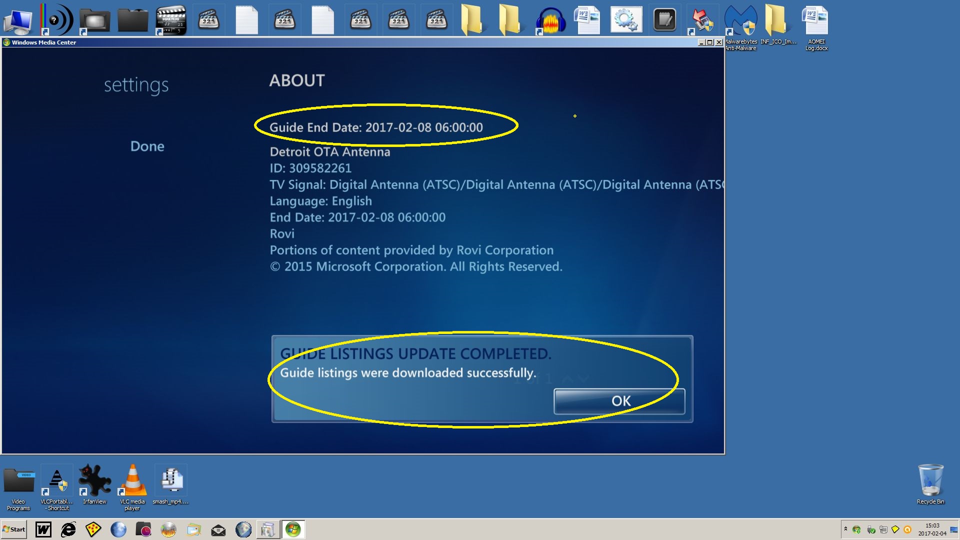

    Right now the guide ends at 18:00 on 2017-02-08, normally there is more than ten days.
    I've tried adjusting the wmc feature by turning off/rebooting/turning on/rebooting with no change.
    Re-scanning for ota stations etc.
    Tried a different zip code, restoring the PC back to Jan 17 using an image to no avail.
    Forcing a guide update gets me mixed messages.

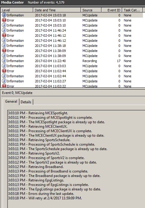

    Included the event log which says there was an error while the information generated in the GUI says it was OK.
    Any help?
    [Attachment 40447 - Click to enlarge]
    [Attachment 40448 - Click to enlarge]
