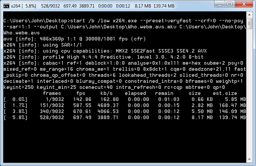

If you look at the settings x264 uses you'll see that --crf=0 is translated to --qp=0 before encoding starts. And it generates exactly the same results.
[Attachment 40441 - Click to enlarge]
As you can see, I specified --crf=0 but x264 used rc=cqp and qp=0. Any crf value below 1.0 will give the same qp=0 encoding. -
Likely some user error. Even your x264 results - there isn't such a thing as "close enough". Lossless is either/or . I can't reproduce your results. Both are truly lossless when encoded / tested properly. (This means at the same chroma subsampling, same bit depth etc...)
