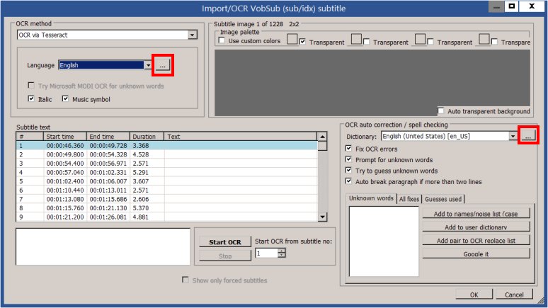

  2. In Version 3.5.1: Spell Check -> Get Dictionary
    Similar if you want a dictionary or Tesseract data you can do this during OCR using the three dots.

    Thanks for your answer. But I know that of course. But only the three dictionaries I have show up. Not the new one. So I must have done something wrong with the installation. Do you know what?
