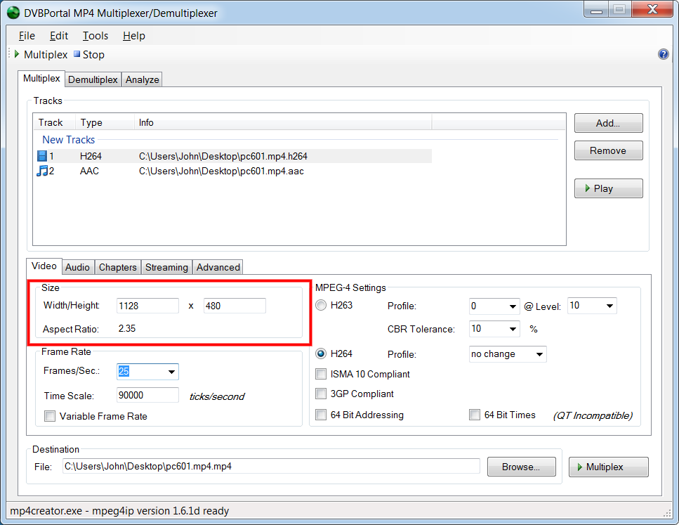

    With MP4Muxer: the actual frame size of this video is 854x480 (~1.78:1) . But the header flags are telling the player to play it at 1128x480, or an aspect ratio of 2.35:1:
    [Attachment 40437 - Click to enlarge]
