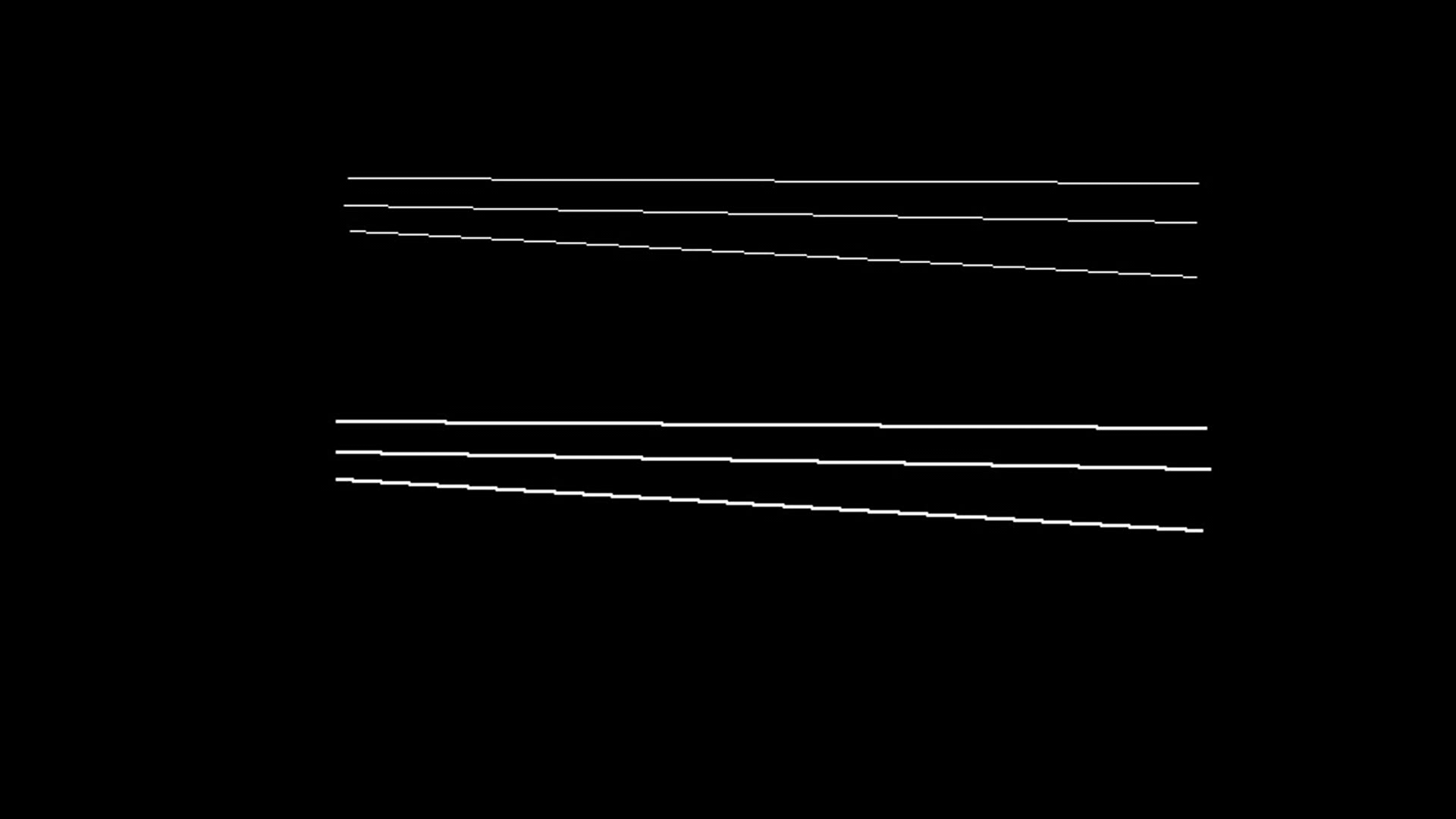

  6. I would avoid scaling like that with ffmpeg. It's basically the same as SeparateFields().Upscale(1920,540).Weave() -- a very poor way of upscaling interlaced video unless it's very fuzzy to start with. It will leave nasty artifacts on sharp horizontal edges. Here's an example, a still frame:
    480i:
    [Attachment 40417 - Click to enlarge]
    1080i:
    [Attachment 40418 - Click to enlarge]
    Be sure to view those images at full size. You're much better off with
    QTGMC() # or Yadif(mode=1)
    Upscale(1920,1080)
    SeparateFields()
    SelectEvery(4,0,3)
    Weave()

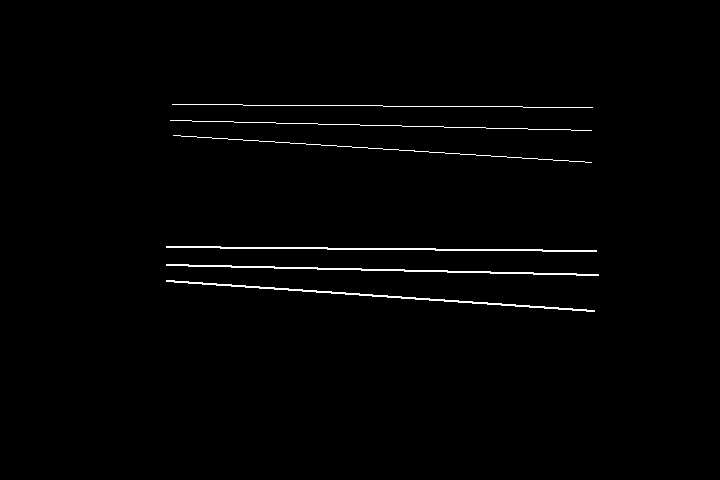

  7. Yes, that's terrible, nice illustration jagabo.
    Or you can use yadif double rate , resize, tinterlace (or interlace) , colormatrix in a linear filter chain with ffmpeg
     -vf yadif=mode=1,scale=w=1920:h=1080:in_color_matrix=bt601:out_color_matrix=bt709,tinterlace=4
    and if it's too soft, you can use sws flags to change to lanczos instead of bicubic scaling algorithm , but it's sometimes not a good idea depending on content/noise and "sharper" is sometimes problematic for interlace
     -vf yadif=mode=1,scale=w=1920:h=1080:in_color_matrix=bt601:out_color_matrix=bt709:sws_flags=lanczos,tinterlace=4

    Yes, that's much better:
    [Attachment 40419 - Click to enlarge]
