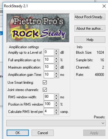

    Had a listen to them, thanks for uploading, I have just updated foobar to 1.4.4 beta, I really do not know what is going on, but since I updated it my normal settings that i had are working, i must have done something wrong, saying that it could be something to do with windows 10 as when i got the satisfied settings previously i was using windows 7. so i don't know if that is what is causing the issues, but seems to be going ok so far these were the settings i was originally using i have adjusted calculate rms to 4 and rms window width to 80, seems a good solid setting, i dont apply any replay gain to them i just apply target volume to the files at 84db and it's what i was happy with
    [Attachment 48980 - Click to enlarge]
