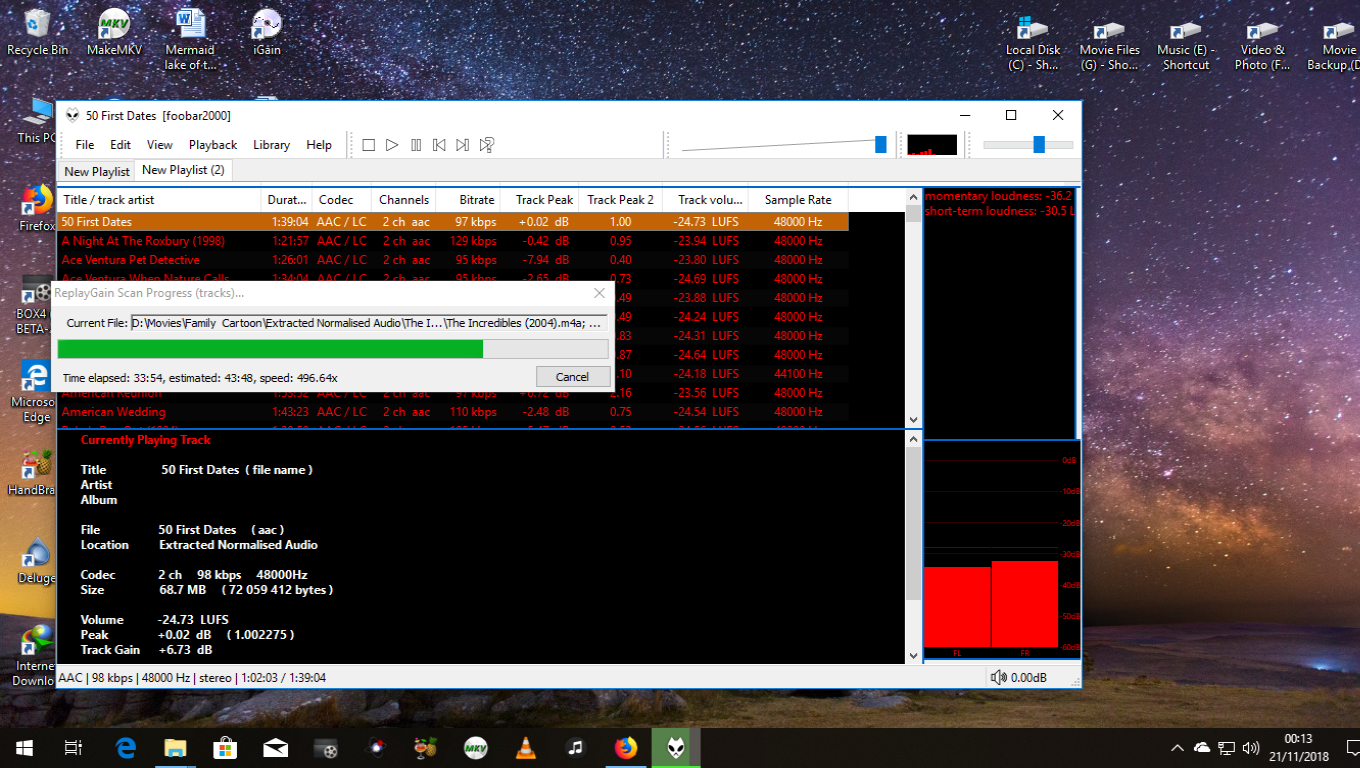

  4. Been messing about with foobar big time tonight, I have my interface the way I want it, excellent program, need to sort out font colors and stuff but amazed how fast I'm learning it, usually I wouldn't be bothered with so many things to edit and customize but deffo love it, would be good if there was an actual column out there so that you could see if a track is going to say track will be clipped during track gain alteration, but then again there is that option apply gain and prevent clipping but would be good to see it as mp3 gain does, it analyzes the track and afterward it tells you if it would be applying clipping, anyway tell me what you think, need to make some adjustments but with your now playing text, it helps a lot

  5. Your setup is looking pretty good, although the Peak Meter displaying so many channels in the 1st screenshot confuses me. The playing file appears to be stereo. Were you using a DSP to upmix on playback, or something similar?
    I know what you mean about determining if there'll be clipping after adjusting. I generally just apply the adjustment and then check for peaks above 0dB and for those, adjust them down if need be (I don't worry about peaks just a fraction over maximum (up to around 0.5dB). Originally, I added the "Selection Properties" element to the GUI and enabled the display of ReplayGain info, because when multiple files are selected, it stops displaying any TrackGain info and only shows the highest peak for the selected files (as "total peak"). If it's greater than 1.0000, then at least one file has a peak above maximum and I'd know to look for the culprit(s). For a long time, that's how I made checking the peaks after adjusting a bit easier, but now we have the Track Peak info displaying as a Playlist column it's not too hard to check each file after adjusting. Anyway... the 1st screenshot below shows my "File Info" tab with the "selection properties" element displaying the loudest peak, although that tab is a bit redundant now. I should remove it.
    Have you played around with the Facets library viewer yet? Once you start managing your song library you'll probably want to. The two columns on the left of my fb2k setup are Facets columns. If you don't have it added to the GUI as an element, you can still use it via the Library/Facets menu. By default, it opens up something like the second screenshot below. The columns interact, so for me clicking on an Artist name in the left column causes the Title column to display just the tracks by that artist (as per the 3rd screenshot), but that's just how I prefer it. It's quite configurable. fb2k's Library Viewer/Playlist combination of doing things can take a little getting used to, but now I can't imagine doing it any other way.
    Facets has a filter that can be used to effectively divide your media library into sections if you wish to. For example, I have original CD rips in a different location to the MP3 versions. To display them as individual media libraries I've created filters that only show the contents of certain folders (and their sub-folders). It's easy as you don't have to specify the full folder path, just a section of it that's unique, so I have two Filters (configured under Media Library/Facets/Filter). One filter's syntax is something like "My Stuff/MP3s" and the second is "My Stuff/CD Rips". The Filter drop down menu makes it easy to switch between them.
    A library viewer is the way you'd normally add stuff from your media library to a playlist, because you can't play anything unless it's in a playlist. By default, Facets switches between being a Library viewer and a Playlist viewer when you select a playlist tab. I don't like that behaviour so I have it configured to always display the contents of my media library. That way, the left side of my fb2k configuration just displays the media library contents and the right side just the playlist contents. My brain seems to prefer it that way.

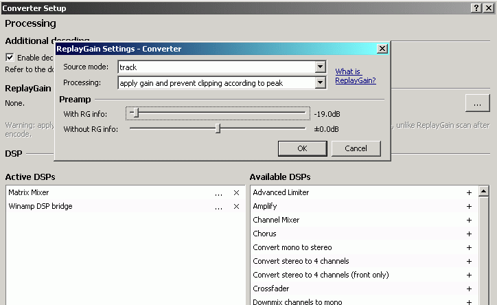

  7. Are you converting to AAC, then scanning with ReplayGain and converting again to compress? If there's two conversions in your process the first one should ideally be to a lossless format, but I'm not sure I'm understanding correctly.
    To confirm... you have been downmixing and compressing at the same time, and in that order? As per the 1st screenshot below? The audio is still being downmixed before it's compressed but as a single process. The result should be the same as doing it in two stages. If you want to adjust the volume after compressing you can downmix, compress and convert to a lossless format, or you can convert directly to AAC and adjust their volumes losslessly, but to me it doesn't make sense to adjust the volume with ReplayGain before compressing as the compression will change it.
    Unless.... you're adjusting the volume to 70dB(?) before compressing because you think the Rock Steady plugin works better that way. If so you can still do it in a single step (after scanning the source files and saving the Track Gain data). The ReplayGain processing in the second screenshot would adjust the volume to 70dB first, followed by downmixing, and then compression.
    For the record, if you scan 5.1ch audio to determine the volume, it doesn't translate directly to the volume of a stereo version after downmixing. I wish there was a way to scan 5.1ch audio and use the ReplayGain info to adjust the volume by the correct amount while downmixing to achieve a particular target volume, but unfortunately it doesn't work that way. For the purpose of using the ReplayGain data to adjust the volume before compressing though, the audio would be adjusted to the same volume, so the compressor would have a similar amount of headroom to play with, which I assume is the main reason adjusting the volume before compressing.
    Personally, I'd just reduce the volume by a fixed amount, and then there'd be no need to run a Replay Gain scan before downmixig. As per the 3rd screenshot.

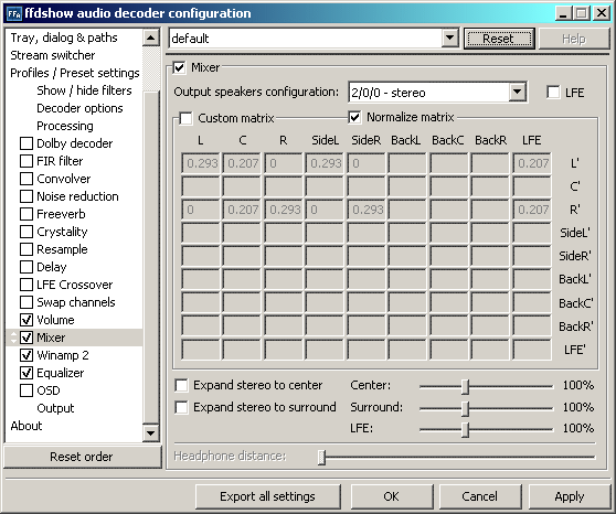

    I'd downmix with the Matrix Mixer's "normalise" option enabled, followed by the Amplify DSP to reduce the volume by a fixed amount, followed by the compression. To prevent the Winamp Bridge from limiting any peaks before it converts the audio to 16 bit, the loudest peak should be -6dB or less. Generally the volume for 5.1ch audio should be somewhere in the vicinity of -23 LUFS (around 83dB) so a fixed reduction of 10dB should be plenty, and it should keep the peaks safe from the Winamp Bridge's limiter. How much you reduce the volume is up to you, but I'd be trying to do it all in a single step as much as possible. There's no reason why the result should be any different to doing it in two or more steps, assuming the same volume adjustments are applied etc.

    My steps are
    convert to Apple AAC lossless file and use nothing but your matrix to downmix to stereo, once they're complete I scan them converted files and apply a gain of 70DB apply gain without clipping, then I convert them files again, ACC lossless using the Winamp bridge with the settings I mentioned above then scan them and apply a gain of 83db without clipping. I don't scan the 5.1 audio before converting with the matrix mixer, I will do your steps for the next files and see how I get on, but I had to reduce some of the bridge settings as stated above as I was experiencing clipping that's why I did them again, after files have been fully completed I do a scan again and any that are going over peak I reduce the overall volume. i will try your step for the next batch and see how they get on, all in there is only about 120 5.1 channel files so it's not a big deal and not as much time to do it as when i was doing it with pazerra followed by box4 the image below is the completed files all adjusted to 83 db and with apply gain without clipping, they seem to be ok but like i said i had to adjust winamps bridge settings to get these results. hope this makes sense i have added one of the completed conversions so you can listen and tell me if it's ok

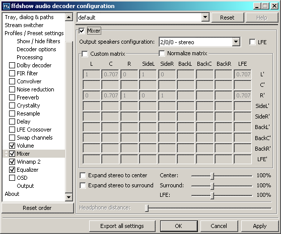

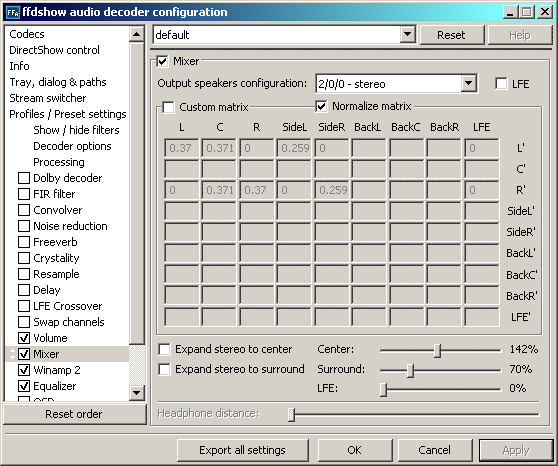

  9. circulationds,
    I ran some more tests myself, starting with some 5.1ch audio from a TV show, and found downmixing followed by a -6dB gain reduction, followed by my usual RockSteady settings worked quite well, resulting in peaks of around -2 dB to -3 dB. When I tried some loud audio from a couple of movies it was a different story though. One was 5.1ch DTS and the other 5.1ch AC3. I scanned them just to see, and the DTS audio had a volume of -17.62 LUFS with a Track Peak of -00.17 dB. For the AC3 audio the volume was -13.90 LUFS with a True peak of +07.03 dB. Chances are the AC3 contained info to reduce the volume on playback, but I have the AC3 decoder configured to ignore it. That's my theory anyway. I might check it tomorrow.
    Anyway, I experimented a bit, trying to get away with not having to reduce the volume much, and without reducing the compression if possible. After a few trial and error runs, the following seemed to do the trick.
    First the matrix mixer in the DSP chain with my usual settings and "normalise" checked.
    Second the Amplify DSP set to -12 dB.
    Third the WinAmp Bridge with my usual Rock Steady settings, with the exception of lowering the "Amplify up to" setting to -6dB.
    AmplifyTo -6
    FullAmpTo 30
    MaxAmpDB 15
    AmpGainTime 10
    SmartLimit yes
    JointStereo yes
    WindowWidth 75
    RelPos 100
    CalcRmsPer 32
    The end result for the stereo output was a volume of -25.04 LUFS and a Track Peak of -00.61 dB for the DST source, and for the AC3 it was -23.12 LUFS and a Track Peak of -00.87 dB.
    They both only just came in under maximum for the peak values, but I suspect the two sources I was playing with would be pretty close to worse case scenario, so I think those settings would be fine most of the time. At worst, the volume should only need to be reduced by a few dB more.
    I've just downloaded your sample but it's pretty late here now so I'll listen tomorrow and report back.
    Cheers.

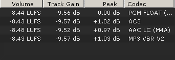

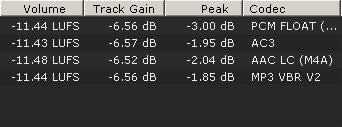

  12. I remember saying I tend not to fuss too much over peaks just a tad above maximum. +0.5 dB would probably be the most I'd live with. Maybe a tad more if I was in a good mood at the time.
    I think that's roughly 1.06000 as a percentage. Is that what you meant by a maximum peak of 0.5?
    The file you're scanning with peaks above maximum..... don't forget some lossy formats do store peaks above 0dB without actually clipping them. Are you sure the peaks are physically clipped rather than being clipped on playback? Do they looked clipped in Audacity if you lower the volume? Audacity will probably import the audio as 32 bit float so I don't think the peaks would be clipped while it's being imported as such, although I'm not 100% what Audacity does.

    Yeah that's what I mean a maximum peak of 0.5, I remember you saying that lossy can store peaks above 0DB but when i played the movie both on tv and pc the same scenes where distorted really bad, like over volume, I played my normalized audio file as well and the same was happening on tv and pc
    yeah they do look clipped in audacity, there are only about 20 files that need working, will finish them off today then all the movies are done, when i open the audio file in audacity you can tell that they are clipped as you do a scan for clipped sections and then use fix clip, that's what i did, will only use audacity for any i come across in the future as it is time-consuming and with foobar i just set my converts up before bed and let them do there thing.

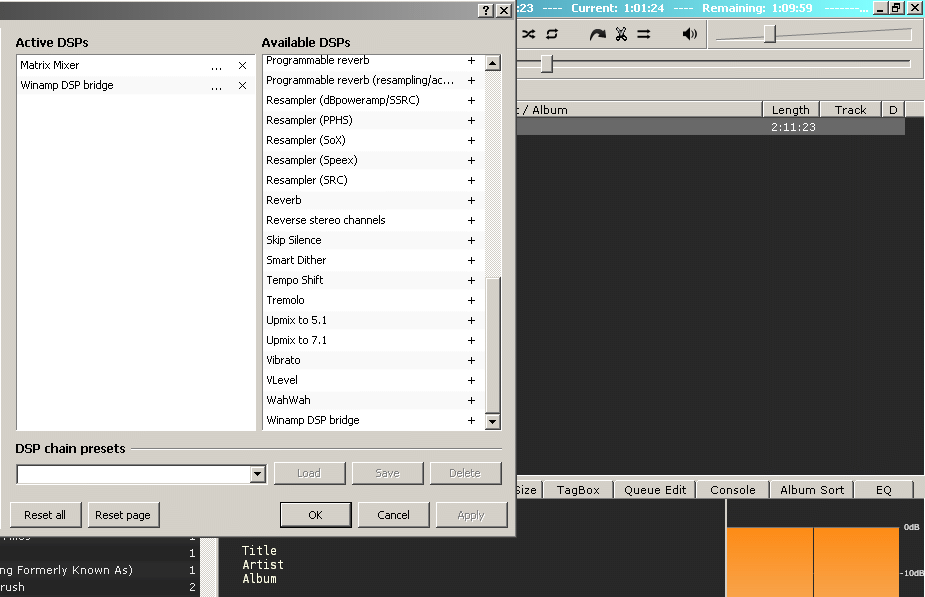

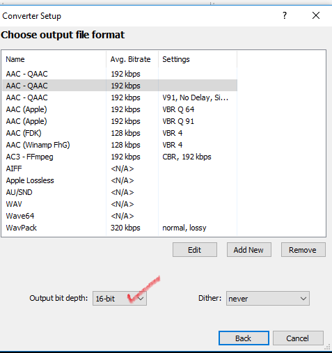

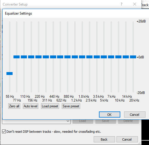

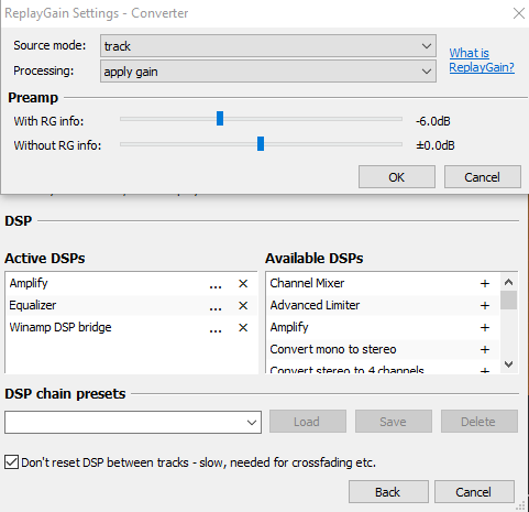

    Hi mate,
    Thanks for sending the text display, I will have a look at them sometime today, I have been messing around with movies again as I forgot what to do and was getting clipping issues with a couple, but have found a good set up now and happy with them, maybe you can give them a spin and tell me what you think?
    Extracted 5.1 audio, scanned and updated the tags, Converted them using your matrix normalized settings, and used the following conversion qaac.exe;qaac64.exe/ --ignorelength -s --no-optimize --no-delay -V 91 -o %d - I didn't add the -N-- for normalizing as you have that already with the matrix mixer settings, when I had that enabled with the N-- i noticed that the volume kept fading in and out but stopped now as I didn't include the normalization from the encoder
    and my steps as follows for the final conversion,

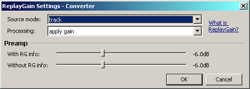

    Set RG with info to -6DB

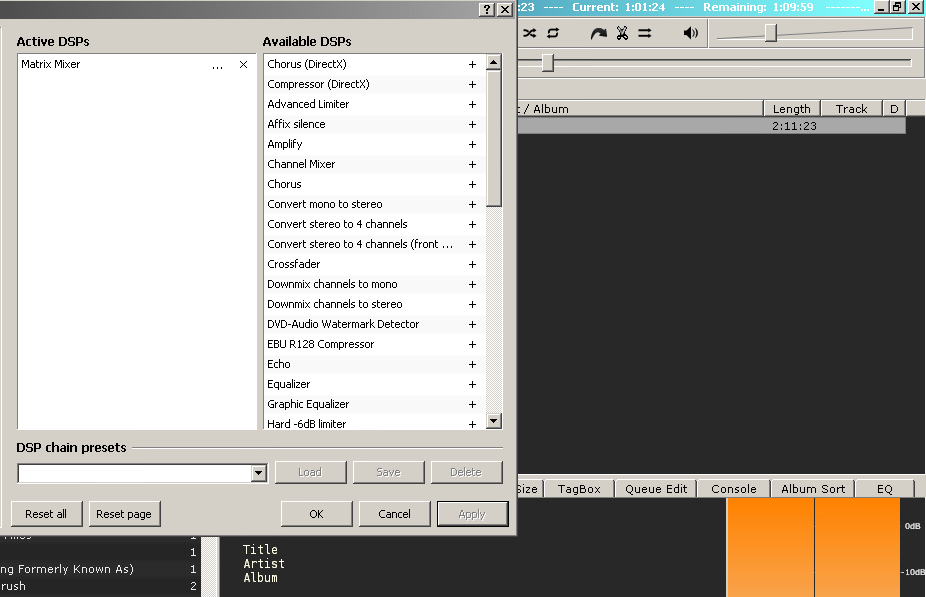

    in the DSP chain i have the following set up
    [Attachment 48692 - Click to enlarge]
    [Attachment 48693 - Click to enlarge]
    [Attachment 48694 - Click to enlarge]
    Seems that the clipping issues were caused by too much bass so i have reduced it a little using the graphic equalizer and seems to have sorted that out, I thought maybe you would like to try the new settings I have tried out.

  18. There's a few things I'd change, but first.... the matrix mixer normalising and the QAAC normalising are two different things. For the matrix mixer, it reduces the volume according to how you're downmixing and the number of channels being combined. It reduces the volume using a set formula so there shouldn't be any clipping after the channels are combined. QAAC's normalising does peak normalising. It runs two passes, finds the loudest peak on the first pass, then adjusts the over-all volume when encoding to peak normalise (peaks at 0dB). I never use QAAC's normalising when "compressing". Maybe I once had a conversion preset saved..... but if I did, it's long gone.
    Your ReplayGain setting is telling fb2k to reduce the volume to 6dB below the standard ReplayGain volume when there's ReplayGain data (83dB). That's a bit pointless when compressing, because the volume will change again anyway. If there's no ReplayGain data, it does nothing. If you just want to reduce the volume by a fixed amount, I think the first screenshot below is correct. It'll reduce the volume by 6dB while ignoring any ReplayGain data, but I'd disable ReplayGain and just use the Amplify DSP for that.
    Edit: I kind of remember you were keen to adjust all audio to the same volume before compressing? Is that why you adjust to ReplayGain's 83dB first?
    If so, the second screenshot below will adjust to 83dB when there's ReplayGain info, or reduce the volume by 6dB when there isn't. If you're following ReplayGain with the Amplify DSP set to -6dB, that'd make it a 12dB reduction in total. If you want it to be 12dB you can just set it to -12dB in the ReplayGain configuration and not use Amplify at all. I think you might be doubling up unintentionally there.
    I don't know what's causing the crackling, unless the audio was clipping pretty hard when it was converted to 16 bit, or because you disabled smart limiting, or maybe because you adjusted the RMS options. I know they're labelled RMS, but if memory serves me correctly, they have dual functions, the secondary function being "crackles". If you want to test that theory, the defaults are 75, 100 & 32. And maybe only convert one file at a time. The WinAmp DSP Bridge sometimes crashes fb2k if I don't.
    With "Full Amp Up To" set to 50%, you've told RockSteady it can apply your specified maximum amplification until the volume reaches -6dB. I have it set to 30%, which is roughly -10dB. It'll increase the chances of volume pumping at 50%, but it should compress a bit more. After the "Full Amp Up To" volume, RockSteady scales back the amplification until it's zero at the "Amplify Up To" volume. It probably wouldn't hurt to set "Amplify Up To" to -3dB to give RockSteady a bit of wiggle-room.
    You can leave the Matrix Mixer in the DSP chain (and configured for downmixing to stereo) when converting stereo audio too. If there's only two channels in the audio stream, and left and right aren't "matrixed" (they just stay in left and right), Matrix Mixer will simply pass them through untouched. Not that it matters, but I thought I'd mention it.
    So if all you want to do is reduce the volume by 6dB before compressing, you can use
    - Amplify (-6dB)
    - Matrix Mixer (normalising enabled and downmixing to stereo)
    - WinAmp Bridge
    in the DSP chain, and leave ReplayGain disabled. Otherwise you might as well set the ReplayGain option for the pre-compression volume you prefer and then you won't need Amplify.

  19. Originally Posted by hello_hello View Post
    - Amplify (-6dB)
    - WinAmp Bridge
    I have tried my old settings and what you have recommended, are AC3 files a problem, as I'm noticing I'm getting clipping on these sorts of audio files, would it be better to get dts files instead? I've just tried a dts and same thing so that was pointless, I have added the extracted audio can you please have a look at it for me and tell me what settings you used to stop it clipping, I have gone through all your steps and i honestly don't know what i am doing wrong?hello_hello.rar it clips really bad at 1:40:43

  20. When you said "clipping" were you referring to something you can hear? I assumed you were, but are you referring to a ReplayGain scan of the compressed/encoded audio reporting peaks above 0dB? If it's the latter, that's what lossy audio does. The only way to avoid it is to reduce the volume by 3dB before it's encoded. At least when using RockSteady to compress, you can follow the compression with the Amplify DSP to reduce the volume.
    I took a FLAC file with a peak of 0dB and ran it through RockSteady while encoding to different formats. Then I did the same again, but I followed RockSteady with the Amplify DSP to reduce the volume by 3dB. Here's the scan results.
    Image Attached Images

  26. If you're referring to the thin lines bouncing up and down above the main meter bars, they don't indicate clipping. The peak meter responds quite quickly, so it's hard to tell how loud the peaks actually are. Those thin lines hold and display the peak level for a little longer to give you time to see it. If they go over 0dB, that's an indication of clipping, but I'm not sure I saw that happen.
    RockSteady is only 16 bit, so like a 16 bit wave file it can't output values above 0dB. If it's the last DSP in the chain, 0dB is the limit. Take a look at the screenshots below. I used the ReplayGain section to give the audio a 20dB boost before downmixing. The matrix mixer's normalising expects audio at a standard volume, so if it's boosted it won't be reduced enough to prevent clipping. You can see what the peak meter is displaying with and without RockSteady. With RockSteady in the chain the peak did sound a little distorted, but there wasn't any horrible "digital" clipping.
    I heard some obvious "volume pumping" in the Creed audio towards the end. The commentator's speech was going up and down. That's because it's barely above the background music, and it's what's causing RockSteady to adjust the volume. The speech is going along for the ride.
    That can be a side effect of compression and is one reason why I never include the LFE channel when downmixing. If you'd care to upload a sample of the audio from that point I can have a play, but using my RockSteady settings that sort of volume pumping can happen on occasion, although I find it very untypical. The only way to fix it would be to slow the compressor's response time or reduce the compression. The former will make the increasing and decreasing of the volume more noticeable. A bit like turning the volume down when it gets loud and then slowly turning it back up again. That's how the normalising built into MPC-HC and ffdshow works, which is why I don't like it. The compression built into most hardware players (night mode, or something similar) is usually quite slow so there might be less of the "Creed effect", but you can often hear low volume background sounds slowly increase and decrease in volume between loud foreground sounds.
    You could try giving the centre channel a bit of a boost in the matrix mixer. Put it in the left and right channels at 1 instead of 0.707, but I don't think it'll make much difference.
    The ffdshow screenshots should help show what the matrix mixer's normalising does as I'm pretty sure it works the same way (although the numbers are a bit hard to read).
    #1 is an un-normalised mix (ffdshow doesn't reduce the surround channels by default and it includes the LFE channel).
    #2 is with normalising enabled.
    #3 is how I usually run it, if it was un-normalised
    #4 is how I usually run it, normalised.
    As you can see, 2 and 4 are different because the normalising matrix is adjusted for the missing LFE channel and the boost to the centre channel. The centre channel boost is mostly just placebo though, because after the audio is compressed it doesn't make much difference.

  30. I thought I heard some "crackles" but I wasn't sure if it was part of the audio or not.
    Changing that setting shouldn't make a difference, although as a rule, bit depth shouldn't be an option for lossy encoders. If they're configured as lossy, it won't be. fb2k will automatically output the correct bit depth according to what's set in the encoder configuration. That bit depth setting in your screenshot wouldn't have an effect until after the DSPs.
    For lossless encoding, the bit depth setting allows you to convert a 24 bit lossless source to 16 bit etc, and when it's set to "auto" the output bit depth is the same as the input bit depth. For lossy sources, the output bit depth is 16 bit when it's set to "auto" and the output is lossless.
    So if the encoder is configured as lossless, "auto" and 16 bit should do the same thing.
    When the encoder is set to lossy, the bit depth setting shouldn't be shown when you select the encoder. The bit depth is only controlled by the bit depth specified in the encoder configuration. I checked, and even though RockSteady is 16 bit, if a lossy encoder is configured for 32 bit, the bit depth of the audio sent to the encoder is 32. Chances are, the WinAmp DSP bridge outputs 32 bit even though you're using a 16 bit WinAmp DSP. It'd make sense for it to do so, as that'd keep the rest of the DSP chain 32 bit.
    You can see what's being sent to the encoder by checking the Console log. This conversion included RockSteady. I still don't know how that setting could have caused or prevented those clipping sounds, given the peaks didn't look like they exceeded 0dB.
