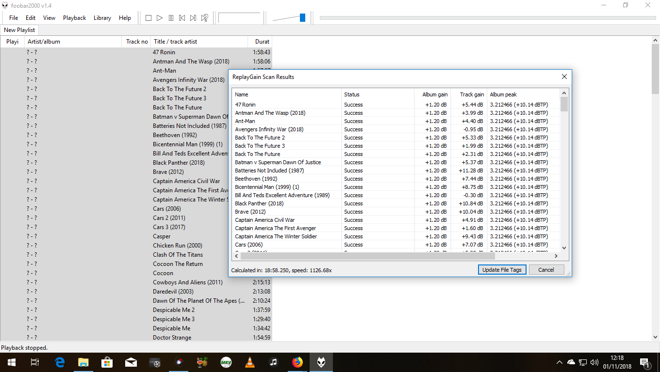

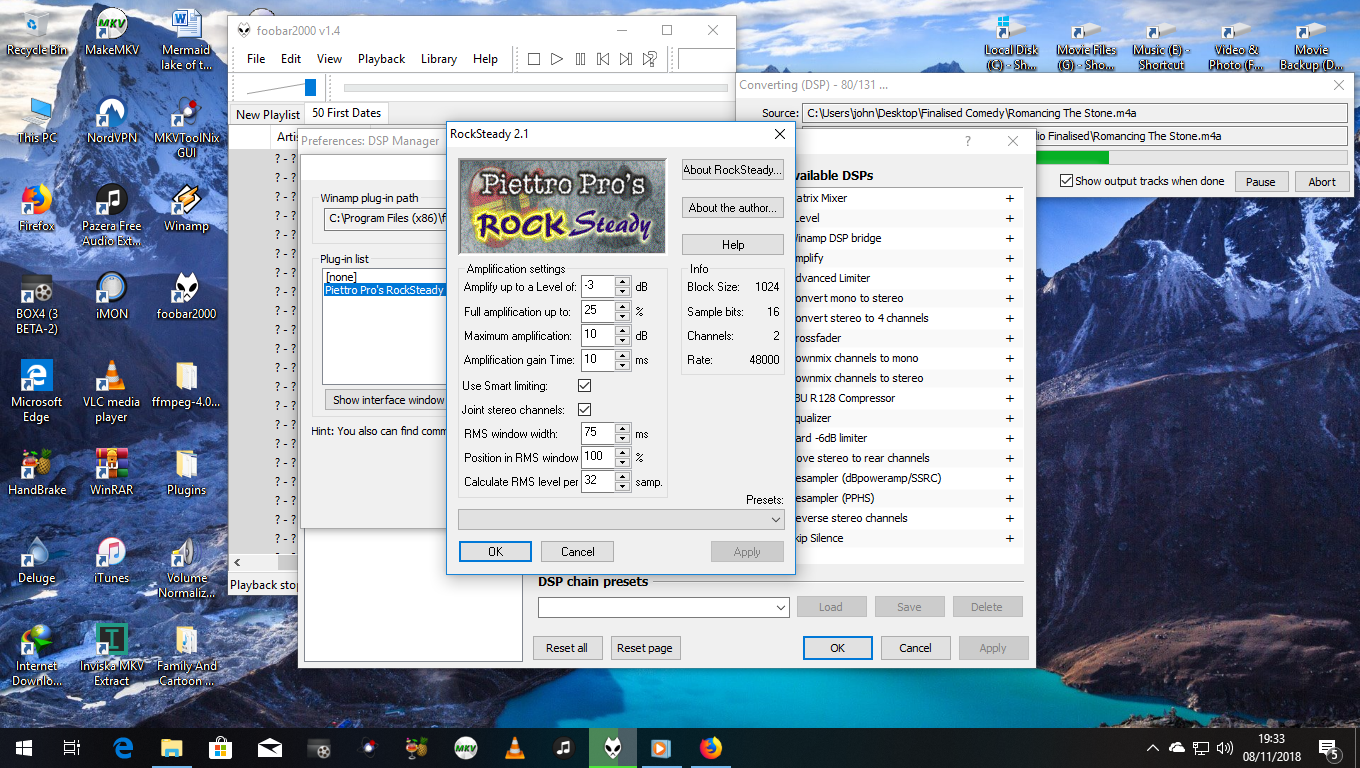

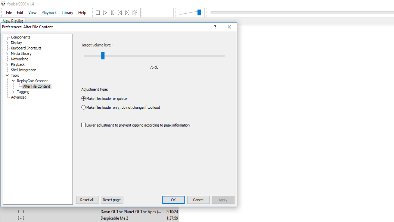

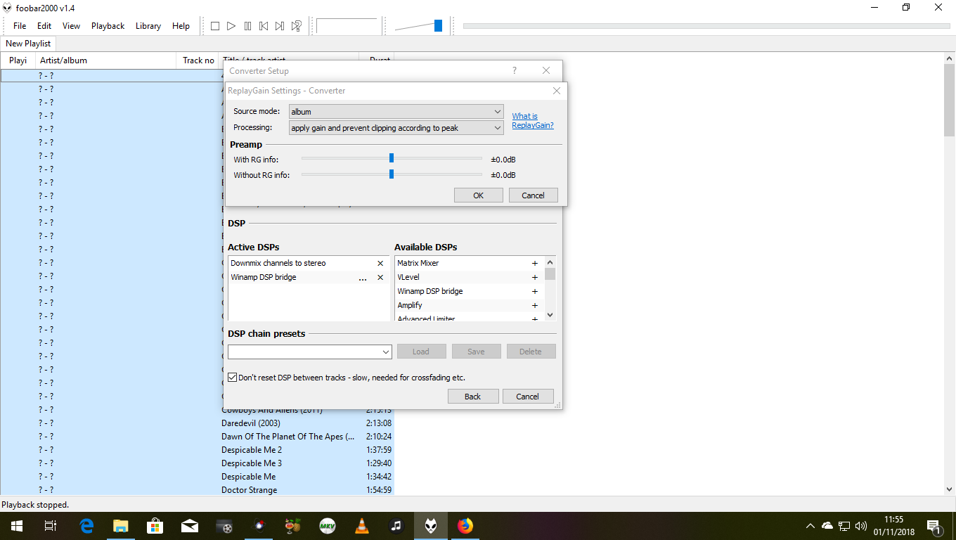

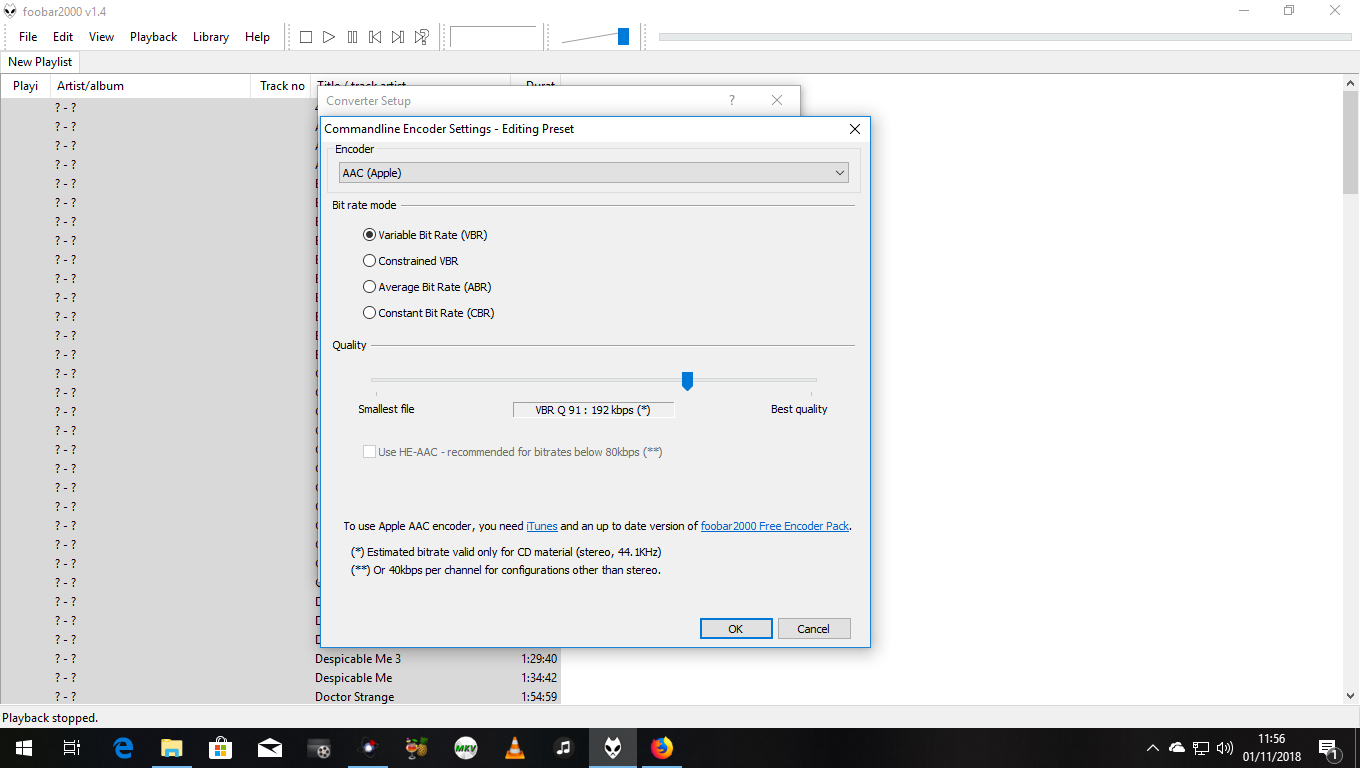

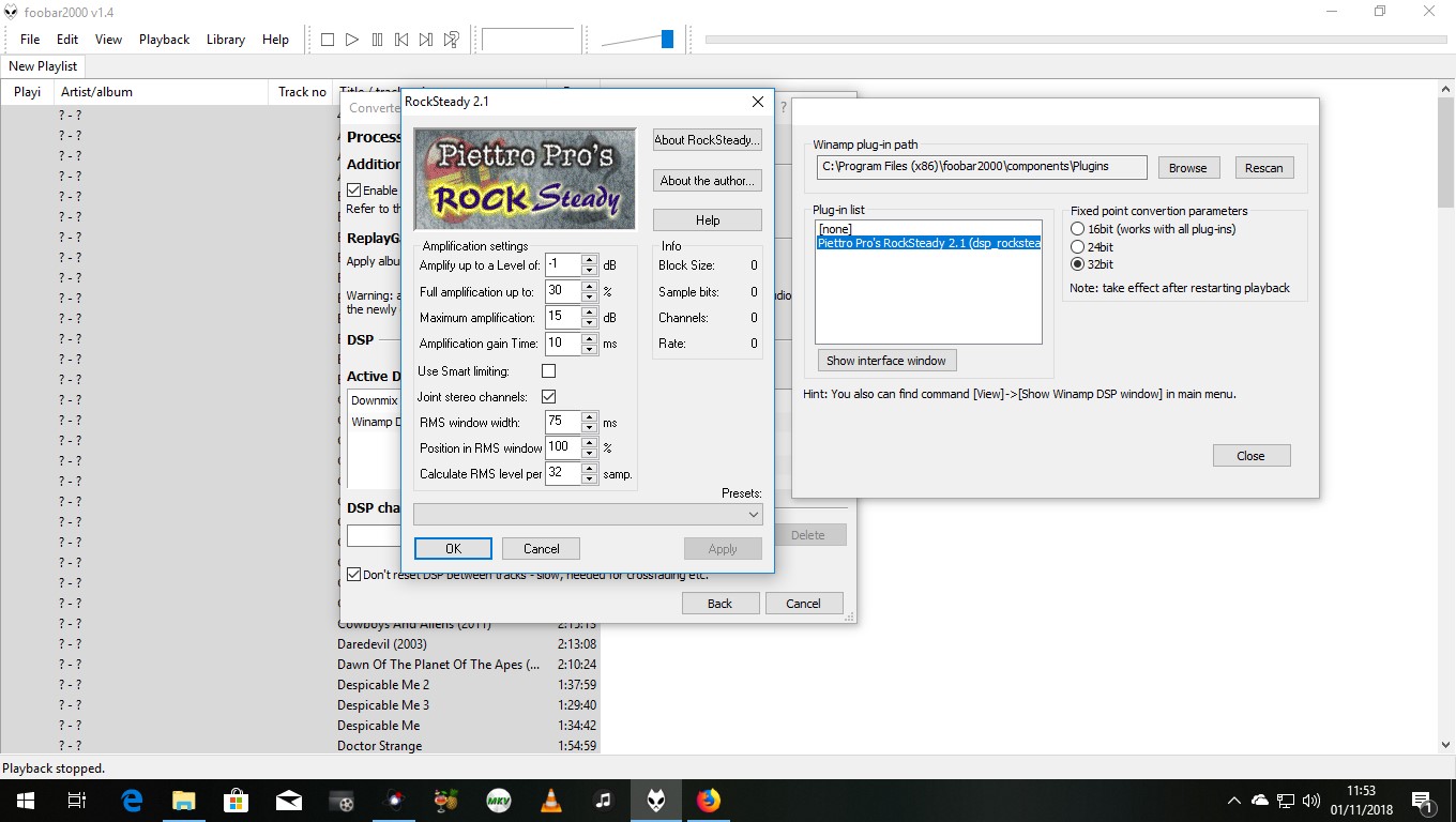

    circulationds,
    thoughts regarding your screenshots.....
    Screenshot 1:
    You should use Track Gain (and a Track Gain scan) rather than Album Gain. Album Gain is designed for scanning a group of files as an Album, so when you apply ReplayGain each track is adjusted by the same amount. For an Album, their relative volumes remain the same. To adjust each track to the same volume, use Track Gain (although Album Gain will probably do the same thing as long as you only scan a single file at a time).
    Normally you do want to reset DSPs between tracks, so uncheck that option (it was possibly contributing to the fade-in, fade-out problem).
    Don't forget you can't adjust the volume to a particular ReplayGain volume while converting and compressing at the same time. The ReplayGain option adjusts the volume before it's compressed. If you want to compress and adjust the output files to the same volume, it needs to be a 2 step process.
    Downmix, compress and output to a lossless format such as a wave file. Scan the output wave files with TrackGain. If any have peaks of 1.00000 (100%) or greater they could be clipped, but assuming they don't.... save the ReplayGain data to the wave files, then convert them to the final format while adjusting the volume with the ReplayGain option. Chances are, after compressing they'll all be a quite similar volume and the ReplayGain adjustment won't be necessary, assuming you're only doing it to make them the same volume. If it's unrelated audio, such as different movies, I wouldn't bother with the ReplayGain step.
    I'd use my matrix mixer settings for downmixing rather than the fb2k dsp.
    Screenshot 2:
    For QAAC, use this custom command line instead of the fb2k preset:
    --ignorelength -s --no-optimize --no-delay -V 91 -o %d -
    Same thing as the fb2k preset you're using, except with the --no-delay option added. Why.....?
    All lossy encoders add padding (silence) to the beginning and end of the audio (something like 50ms for AAC). The amount of padding is saved when the file is encoded, but that info can be lost when muxing (although MKVToolNixGUI does account for it when muxing AAC, if the info exists). The --no-delay option tells QAAC to remove the initial "padding". For soundtrack audio it means the audio/video sync can't be effected. Don't use --no-delay for encoding CD tracks (for various reasons), but it's a good idea for soundtrack audio.
    Screenshot 3:
    RockSteady only accepts a 16 bit input. If you select 32 bit in the WinAmp Bridge DSP, as per your screenshot, you'll either have no audio or it'll be passed through uncompressed (I can't remember which). RockSteady doesn't support multichannel audio either. It's probably also a good idea to enable the RockSteady "Use Smart Limit" option.
    For fb2k....
    16 bit means 16 bit integer, much like a 16 bit wave file. Anything above 0dB gets clipped.
    24 bit means 24 bit integer, much like a 24 bit wave file. Anything above 0dB gets clipped
    32 bit means 32 bit floating point. Floating point can store values above and below 0dB. No clipping.
    For lossy source files, fb2k decodes to 32 bit float. All fb2k DSPs I'm aware of process the audio as 32 bit float, so they won't cause the peaks to be clipped even if they end up above 0dB.
    Whenever 32 bit float is converted to 16 or 24 bit integer, peaks above 0dB will be clipped. RockSteady only accepts a 16 bit input, which is why the Winamp DSP bridge includes a peak limiter. I think most Winamp 2.0 plugins are 16 bit.
    Screenshot 4:
    That's the ReplayGain option for adjusting MP3 and AAC audio losslessly, as opposed to adjusting the volume when converting. It works with MP3 and AAC in an MP4/M4A or MKV container, even if it also contains video, or with standard MP3s.
    Scan the file with TrackGain, save the ReplayGain info, then right click and select "ReplayGain/Apply Track Gain to File Content". The volume has to be adjusted in increments of 1.5dB, so it'll be adjusted losslessly to the nearest increment.
    That's a way to avoid intermediate wave files after compressing if you also want to adjust the volume with ReplayGain. You could downmix/compress and convert to AAC, then scan the AAC files, save the ReplayGain info and adjust their volumes losslessly.
    Screenshot 5:
    The TrackGain results show the individual volumes, relative to ReplayGain's target volume. That's 89dB for ReplayGain (long story, but 89dB is actually a sound pressure level, which is why it doesn't seem to make much sense), so in more understandable terms the ReplayGain volume is -18 LUFS.
    LUFS is the term invented for R128 scanning because the audio is kind-of scanned in sections (much like the DAN or RockSteady window size) and apparently an additional level of confusion was required. It stands for "loudness units relative to full scale". LU can be considered the same thing as dB. So a volume of -18 LUFS is the same as -18 dB.
    So when the fb2k TrackGain scan shows +5.44 dB it means the volume needs to be increased by 5.44dB to achieve -18 LUFS, which means the volume is -23.44 LUFS. Mental, isn't it?
    The peak values are dBTP (dB True Peak). Just the loudest peak for a group of files scanned as an album, or the loudest peak for an individual file when it's Track Peak. Zero dB is still "maximum", so +10 dBTP is a fair amount above maximum. QAAC will encode the peaks if they weren't clipped on the way to the encoder, but you really want peaks of 0dB or lower.

    I do still find this 'fade in/out' issue quite intriguing. Me thinking out-loud > Is it just something that's a 'one off', a rare event? Something a little more common? Maybe the current dynaudnorm default settings need a re-think? Is it just a case of a single parameter that needs changing? Could it actually be a fault/bug? With the correct sample it may be worth raising the issue with the dynaudnorm author?
  23. Originally Posted by video.baba View Post
    Originally Posted by circulationds View Post
    It's cool guys i have managed to get a solution, as for the box4 i will still use that, thats how i started off anyway i think it's a fantastic piece of software, just some movies where hard to get a good setting that's all and i don't think it's a box4 problem to speak, i have used commandlines using dynaudnorm with foobar and the same issue was happening, fade in and outs so it has nothing to do with the box4 program handling the dynaudnorm. i think it's cool that someone has went out there way to create such a usful tool for people's needs, lets just say i wish i could create a program.
    Thanks.
    I personaly think that Hello_Hello was right with his comment in regards to the time frame, dynaudnorm is slow at responding in some cases, it's definately to do with the volume being to loud on certain parts then the sound dips down and takes a few seconds to go back to a satisfied level again, i spent a good month playing with the box4 program, the best results i was getting was stated in my first comment in regards to the fading in and out issue. As you know
    video.baba i'm not all clued up in this factor i can only explain to the best i can, but when i was experimenting with the box4 some movies where giving me hassle and i could not get the results i was wanting until i done the converting with pazera and then repacked the lower volume audio's back in with the settings as stated, some movies where perfect but some it didnt work as good.
    At the end of the day i think it's all down to poor downmixed audio, but a good way to start is the volume of the actual source file, maybe changing some of the dan settings within the box4 program, either way we can't get perfection all the time and it's maybe something that will be better over time, with parameters and stuff maybe change the default window frame down a bit and the gaussian filter is too slow to respond on 31. But even using the dynaudnorm with foobar i was getting the same issue with the bride of chucky movie and a few others so it has nothing to do with the box4 program it's the dynaudnorm itself.
    Maybe you can try and implament the rocksteady plug-in that's done a good job so far but i'm not 100% clued up like you guys on here but will definately give you my thoughts the best way i can, all i know is from hello_hello is the rocksteady dsp doesn't handle 5.1 audio files so has to be downmixed to stereo before the efects can work. there is also a matrix mixer with settings that hello_hello created to downmix the audio and normalise at the same time. I have managed to normalise all my audio with foobar so far but i'm keeping the normalised audio and default audio in my movie files as i did when i was using box4 program. i would however like to learn how to use dynaudnorm on it's own one day as i do enjoy a challenge but it's a bit frustrating that i don't have the full knowledge yet for doing this
