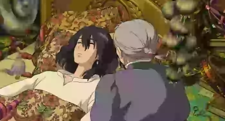

  1. I use the following sentence to create a 14-second video in FFMPEG:
    ffmpeg -i video.mkv -vf subtitles=video.mkv -ss 00:49:32 -t 14 -c:v libvpx -b:v 15m -sn -s 700x394 -crf 14 output.webm
    The result was like this:
    https://webmshare.com/rZ4XQ
    It's fine and all, but if notice, for some seconds the quality drops, like this:
    And then immediately goes back to this:
    I can't find any fault on the ffmpeg sentence that would give this problem.
