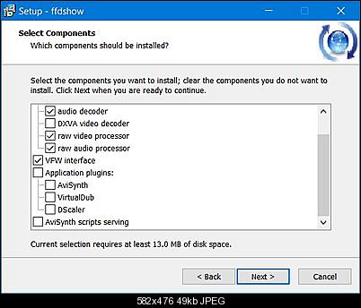

    Am I missing anything? Do I need to change any other defaults in the ffmpeg installation and/or settings? And is it safe to check all of the options seen in this photo (including those left unchecked by default), in case I ever need the unchecked components/plugins:
