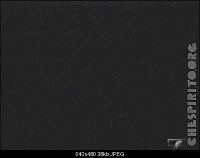

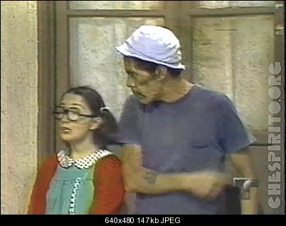

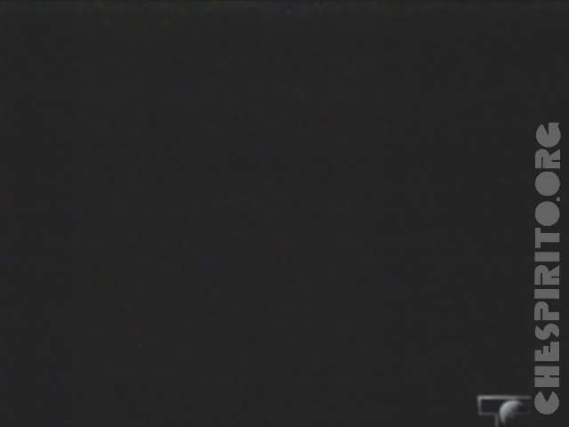

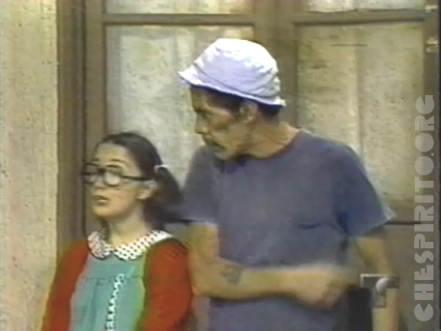

    Hello everyone! I need help with a video... the thing is that it has a watermark at the right border, but I don't know how can I remove it. Here are some pictures:

    The only way to truly remove it would be to crop that side of the picture out of the video. Anything else would just be masking or blurring that area of the screen.
    Do or do not. There is no "try." - Yoda
  3. 1. Use something like VirtualDub Delogo to remove the transparent logo. Since the logo does have transparency, this tool can often do removal without leaving too much of that tell-tale blurred spot.
    2. Crop the part of the video that is already black (i.e., the pillar bars on either side) and then add back black borders.
  4. You may try to invert (negated luminance) logo and overlay it with full alpha around logo on video (for example multiply overlay in Avisynth).
