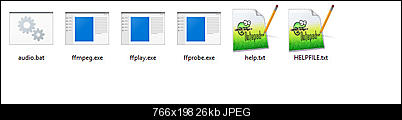

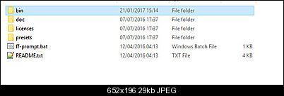

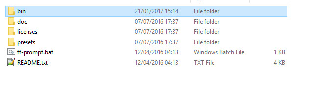

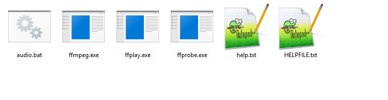

    I was given this script by someone here where you drop a avi movie on the audio.bat icon and it would increase the audio on the movies. But can this be made to also accept .mp4 and .mkv extensions too
    the folder is called ffmpeg-20160412-git-196cfc2-win64-static
    and inside folder is this below
    and inside the bin folder is this
    hope some one can help me to also use .mp4 and .mkv movies too
