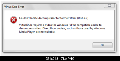

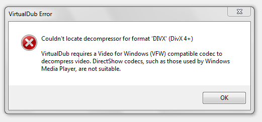

Size:  1.7 KB NoGo with VD:

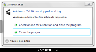

    Double Doh! My luck just continues (I had previously use Avidemux (2.6)
    for editing, never joining:
    Ignorance more frequently begets confidence than does knowledge.

    It doesn't matter if VirtualDub can decode a video to display it; it can still handle its structure, append one to another, in the mode "Video - Direct Stream Copy" (Audio as well).
    And if you still want DivX to be supported, try either installing a VfW codec which can decode it (e.g. Xvid, or ffdshow), or test if VirtualDub FilterMod can use an internal decoder.
