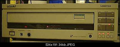

    The industrial LD players are huge, built like battleships, and fun to play with, but they don't always make the best source for digital capture. It depends on the discs to some degree: if they have a lot of grit or dropouts the industrial players may do nothing to conceal them. And problems can arise if you have very recent discs with fancier audio options: the industrial players can't read the newer PCM or AC3/DTS . OTOH, they are often the cheapest players available if you're on a budget and don't have many discs to transfer (I picked up a Sony LDP-2000 for $40 a few years back).
    Video output of the LDP-2000 is remarkably grainy, more so than the consumer Sony or Pioneer models that died on me long ago. But I really only needed it for 2 or 3 rare titles that I couldn't replace with newer better dvd releases, and even those were not worth the effort and expense of hunting down a still-functional Panasonic or higher-end Pioneer to dub from. The Sony LDP-2000 is common, dirt cheap, and usually rock reliable compared to several high-strung quirky consumer models I had owned in the past. Unlike those, the LDP-2000 plows thru any disc you can throw at it with no annoying freezes or hiccups. Maybe not the ultimate in picture quality, but steady reliable non-fussy playback was my priority.
    Sony LDP-2000:
