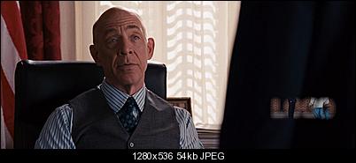

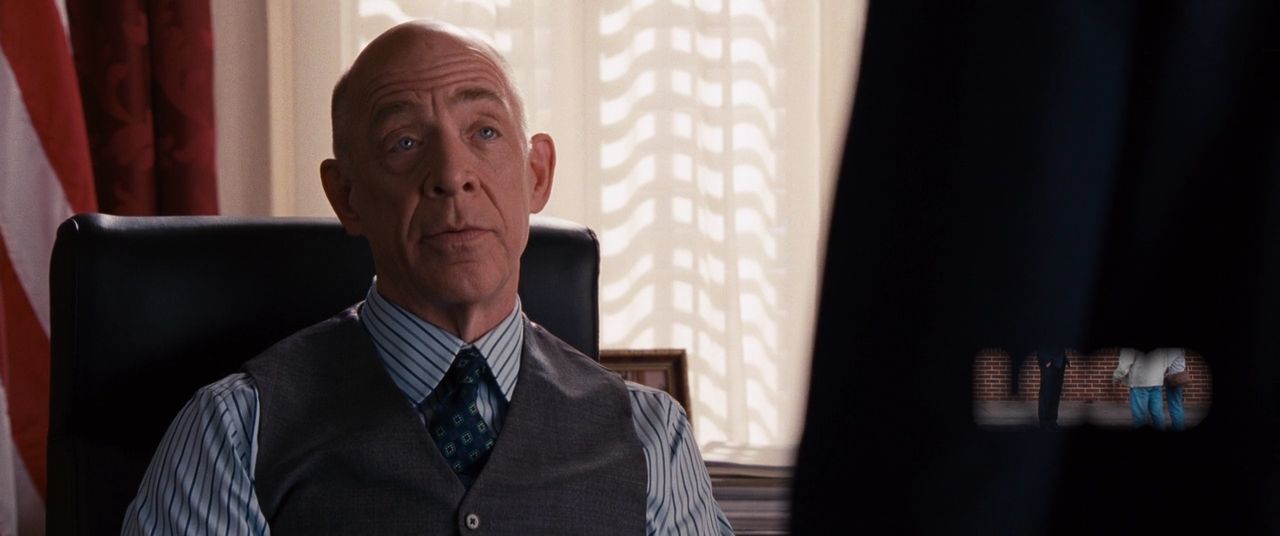

    This is the result when the video with the logo and the video without the logo are completely different, so you can see what it does. The logo area is replaced with the second video. You can cut out a corner and replace it completely, but unless the two videos do match exactly you might be left with an obvious border around the section that was cut out. Whatever works, I guess.
