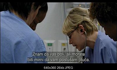

    How to hardcode subs to an input MKV/H.264 file, with the same container and the codec on the output? Subs with semi-transparent opacity box as in the pic down below. Any tools that can do it? It's no problem in VDub using TextSub 2.23, looks great, been using it for years. But how to get the same result with MKV container/H.264 as the output? Other than first reencoding it to AVI in VDub, how to avoid that step? Is it possible?

  2. Use an .ass subtitle with a opaque box with transparency.
    You can hardcode withy Handbrake if you mux the subtite into the source file.

    Thanks vb. Since I have never dealt with .ass subs... how to prepair them to have the desired box look ready for the Handbrake? Is there any subs software tool with options to set to be written in the .ass file itself? Pardon my ignorance.
  4. You could import a .srt in Subtitle Edit and change the format to.ass. Edit the Style to use an opaque box and select it's color (use Outline color.)

    Great, Subtitle Edit does the job, thank you very much!
