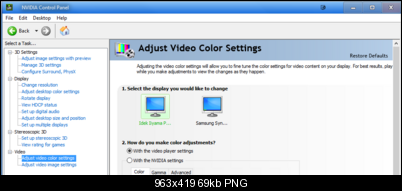

    All video card configurations should have an option similar to this:

  9. Thank you all for replies.
    Full color means 0-255 as shown in Nvidia Control panel>Video Settings as opposed to MediaInfo showing 'Limited'.
    These replies at https://forum.handbrake.fr/viewtopic.php?f=11&t=35636 tell a different explanation of FULL range for DVDs/Blurays:
    "The Handbrake yuv output must always be 16-235 to play back correctly at full 0-255 range. Bet you didn't know that. That one. Is etched on stone tablets." – by musicvid » Thu Jan 05, 2017 11:31 am

  10. The nvidia panel isn't related to how a video is encoded.
    So you should leave it default in handbrake (normal range YUV, which is Y 16-235, CbCr 16-240; mediainfo should say "limited" - that is correct) , and it will get converted to RGB for display properly if the hardware and settings are setup correctly
