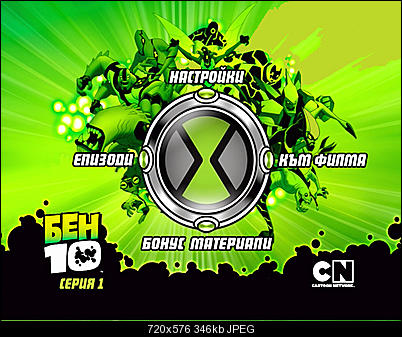

    Anyway, this is the main menu:
Name:	Главно Меню_BG.jpg

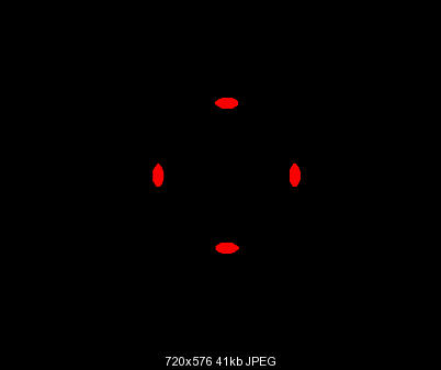

    this is the original subpic:

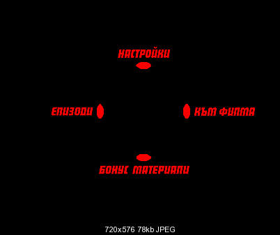

    and the same subpic, edited:
Name:	Главно Меню (2).jpg

    Reading between the lines here, you're probably out of luck unless you go to the trouble of fully re-authoring the disc (this is one of the many reasons why DVD annoys the heck out of me). As just written in another thread, DVD subpictures are actually RLE compressed, essentially using a very simplistic and less efficient form of GIF or compressed-BMP encoding, and their compression efficiency drops dramatically when faced with horizontal detail (which your lettering would certainly count as).
    The uncompressed sizes you found by measuring the image dimensions don't really matter so much in this case; the original subpic will be very, very small on-disc, in comparison to its unpacked size, as it's an RLE encoder's dream - most of the lines have no detail on them at all and can probably be represented in a few dozen bits (a few repeats of "maximum representable number of pixels, colour = black"). The ones occupied by the top and bottom buttons have only two colour transitions per line; essentially you take that same data but interrupt it just before halfway across (maybe changing one of those blocks to define a shorter run of black) and insert an extra block that simply says "X number of pixels, colour = red", where by eye I'd say X varies between maybe 4 and 16, and then pads to the end of the line with black again. The middle lines where the left and right buttons sit insert two similar code blocks, just about one third and two thirds the way across instead. That picture should take up only 1 or 2kb at the very most, if not just a few hundred bytes (heck, the original BMP is only ~6kb, and the raw DVD subpicture data generated from it - which is 2-bit, not 1-bit - would be about 12kb).
    The additions you made are fairly simple, but they're almost as tall - ie, they add red-pixel data to about as many lines - as the buttons themselves at the top and bottom, so at the very minimum making it as if there were two vertically stacked buttons there with the matching additional data load, and similarly the left/right text is at least equivalent to adding an extra two buttons along those middle lines... bearing in mind doing so can also make the black encode less efficiently if the longest run of it between red pixels is less than the representable maximum (in the region of 64 pixels iirc).
    But actually, the text is somewhat wider than those buttons, and is made up of a number of what are essentially separate buttons (ie the individual letters), so that's a lot of extra "red" (and short black) blocks to insert. The data load is already climbing quite rapidly. And then you have to consider each letter's complexity in the horizontal direction, which looks quite fine, certainly like there are red or black parts which are no more than 2 or 3 pixels wide in several places; elements 3 pixels wide is roughly where encoded size is equal to raw size, and 2 or 1 pixel wide blocks actually use more data once encoded than they did originally. The more complex letters may well use as much data each as an entire blank black line does. The total number of bits used to represent the image therefore has gone sky-high.... maybe not objectively so, but certainly in comparison to what it was originally. If the compressed version now takes up 3 or 4kb when originally it might have been less than 1kb, then it simply isn't going to fit. It doesn't matter whether that's actually "a lot" of data or not - if it's a single byte, or even a single bit too long, it will be rejected, as that last bit can't be stored without moving or overwriting something else. And if you're going to move the next piece of the data structure forwards, then even with deletable padding, there's going to be some other value in a data table somewhere that will need to be updated, and it might not be obvious what it is, meaning you'll have to do an exhaustive search of all the rest of the PGC and IFO (and VOB?!) structures just to make sure.
    It might yet be possible to do some clever hacking and make it work, but it depends on how big the actual outline of your subpicture is; it would be useful if, e.g. the area on those mostly-black images that's NOT subpicture could be filled in with some other colour (primary green or magenta is traditional; neither is really appropriate here, nor white, due to possible clashes with the menu image or the subpic detail, so maybe an amber or sky blue?) to better highlight what part of the entire screen it takes up and how much of a border there is, that may help. Given that 244x216 isn't THAT big vs a 720x576 frame, I'm quite surprised and impressed you managed to fit the left and right button text in there, and figure there's likely no fat that can be trimmed off.
    (In fact, looking at it again... no, something's not right, there is NO WAY your subpicture is still 244 pixels wide, unless something very strange is going on with the encoding. I'd expect it to be closer to twice that, and probably 300+ high, and that's without allowing any excess border at all, ie it can't be trimmed down. How did you measure that size?)
    If you still want to highlight the text as well as the buttons, an alternative might be to *outline* it? As in, instead of filling in the white parts within the black outlines (which, to be perfectly frank, might actually look pretty terrible and not be very easy to read, depending on your screen and connection method - NTSC may be infamous for mishandling primary red, especially on a black or white background, but PAL isn't *so* much better at it, unless you have a proper RGB connection; there's a reasonable chance the original menu author did that on purpose to get a fuzzy, glowing effect "for free", even!), you could try putting a red glow AROUND that outline? Maybe even overlapping halfway onto it? But not enveloping each letter, is the thing - the idea is to reduce how detailed the image is, as much as possible, especially in the horizontal direction; which can be achieved very nicely by not drawing the actual letter detail, or putting in outlines that separate each letter...
    And taking it further, it might be possible to trim the actual subpixel outer dimensions down by making it look more like a glow from the buttons as they turn red... so, it only wraps around the upper side of the lower text, lower side of the upper, and ditto for left and right.

    When you export or edit a subpic with DVDSubEdit, it creates an image file the full size of the screen so the subpic is in the correct location. But that's not how the DVD itself handles subpics.
    The image is cropped before it is stored. Only the displayed portion of the subpic is stored in the VOB. The "Set Display Area" in the subpic definition indicates the exact location on the screen where that image is to be positioned.
    So by adding the text to the image, you have effectively changed the image from a 242x256 picture (61952 pixels) to a 527x329 picture (173383 pixels - nearly 3 times as many), and the data won't fit in the same space within the VOB file.
