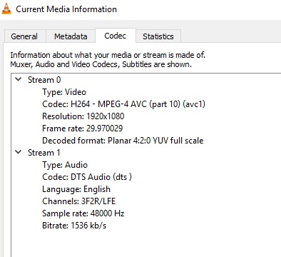

    Any thoughts on how might I get closer to these statistics with a better capture card and/or does one exist?
