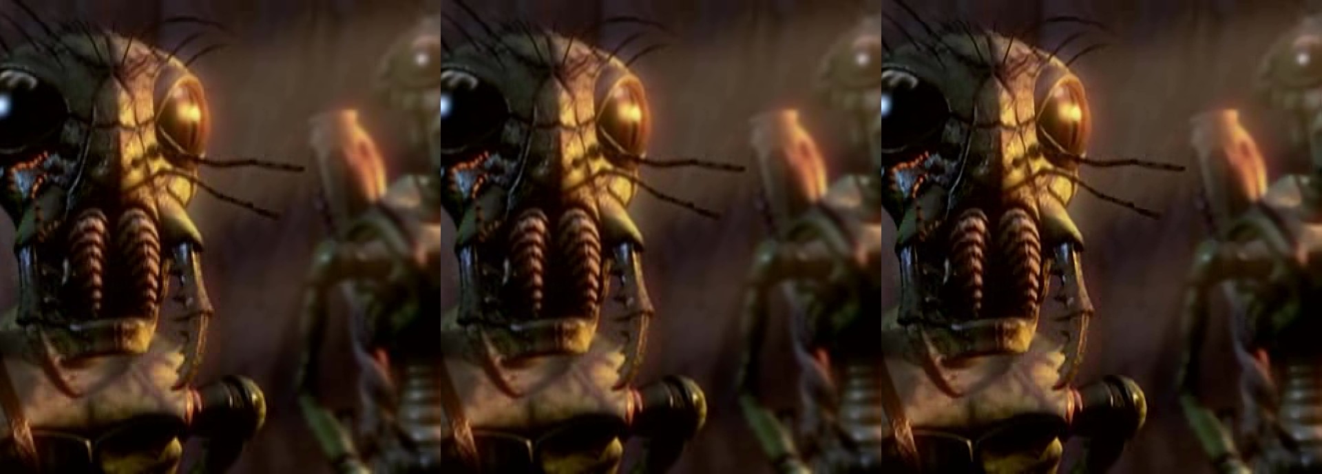

    With a point resize it won't really be any sharper but it will be full of jagged buzzing edges.
    If you have enough CPU power you could use an AviSynth with nnedi3 to play your videos:
    AviSource("Filename.avi")
    ConvertToYV12()
    nnedi3_rpow2(2)
    aWarpSharp(depth=10)
    Sharpen(0.3)
    Then open that script with your media player. Example (point, bicubic, nnedi3+):
    [Attachment 40278 - Click to enlarge]
