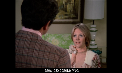

    I'm using WMP to watch my DVDs-all purchased-and I've been getting what I can only describe as a "certain blur around the edges of every seen object".
    Having no special knowledge in the field, I can't tell whether it's a grainy picture or a problem which involves deinterlacing.
    I'd appreciate every attempt of assistance, as I'm almost out of ideas for the time being.
    Uploaded here is a sample picture describing the visual problem:
  2. The aliasing (the stair-steps at the top of the girls shoulder for example) is caused by poor deinterlacing. The overall blurriness looks about normal for DVD viewed on an HD screen. You might be able to get a very slightly sharper image by changing the resizing filter used for video in the graphics driver or player.

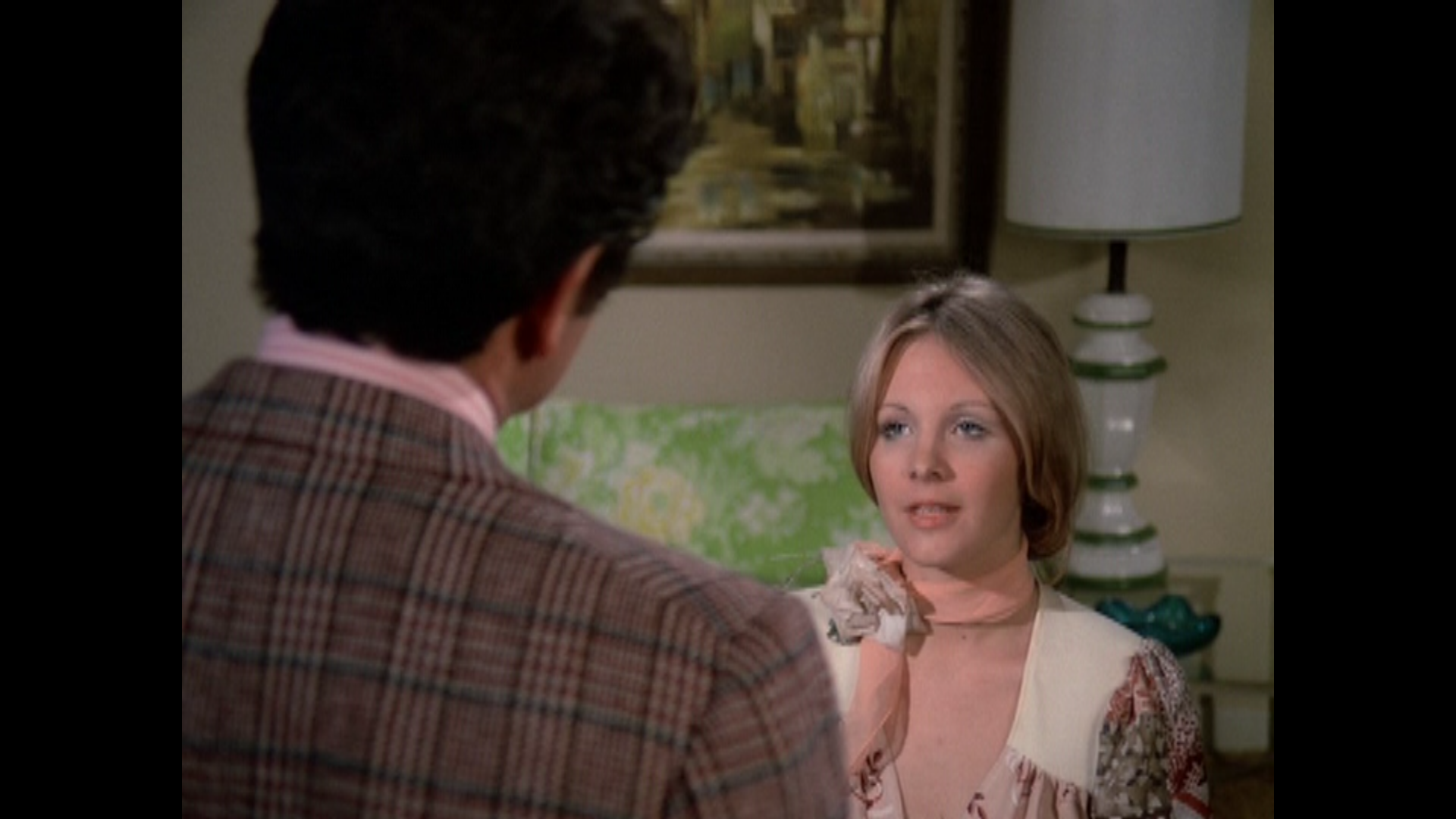

    When WMP fails, I turn to MPC which shows the movie properly. Would've settled with it, only that in full-screen mode (or complete full screen) it tends to lag and the sync gets thrown off.

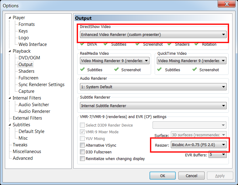

  4. Look for "Film Mode Detection" setting in the graphics drivers. Turn it on/off. See if there's any difference.
    In MPC, check the output device settings, View -> Options -> Playback -> Output -> DirectShow Video. Try different output devices. Try different scaling options.
    [Attachment 40248 - Click to enlarge]
