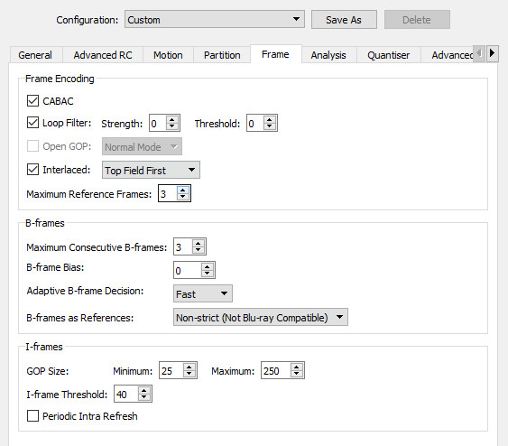

  9. Member Bernix's Avatar
    Apr 2016
    Europe
    Hi,
    so I have interlaced content that I want to be encoded as interlaced. So I always do this.
    [Attachment 43775 - Click to enlarge]
    Is this the fake x264 interlace, or real interlace? Because this works for both interlaced and progressive -> become interlaced. I am using this to append it to other interlaced content. Do I this wrong? When I playing resulting file whole file behave as interlaced, when encoding first part without this and append to interlaced content, the first part is played as progressive and rest as interlaced.
    So my question is is this fake or real? I though it is real and worked with progressive content as well.
    Thank you for your reply.
    Bernix

  11. Dinosaur Supervisor KarMa's Avatar
    Jul 2015
    US
    @Bernix
    With x264 interlacing, it just interlaces the frames that are interlaced and leaves the other progressive frames alone for more efficient compression. So x264 works fine with mixed content in interlaced mode.
  12. Member Bernix's Avatar
    Apr 2016
    Europe
    Thank you KarMa,
    so I do it proper way. Thank you again
    Bernix
