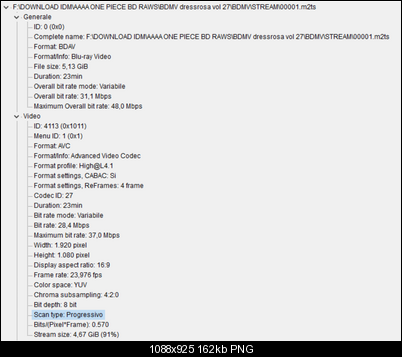

    These are the media info for the "before" m2ts file:

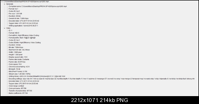

    and this is the "after":

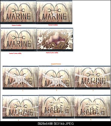

    Now the problem is that after the encoding the video starts with the first 1 or 2 frames, then it freezes for let's say 7 frames, then it plays normal.
    This error also occurred the second time I did the encodeing with the same settings, so it's not an occasional error.

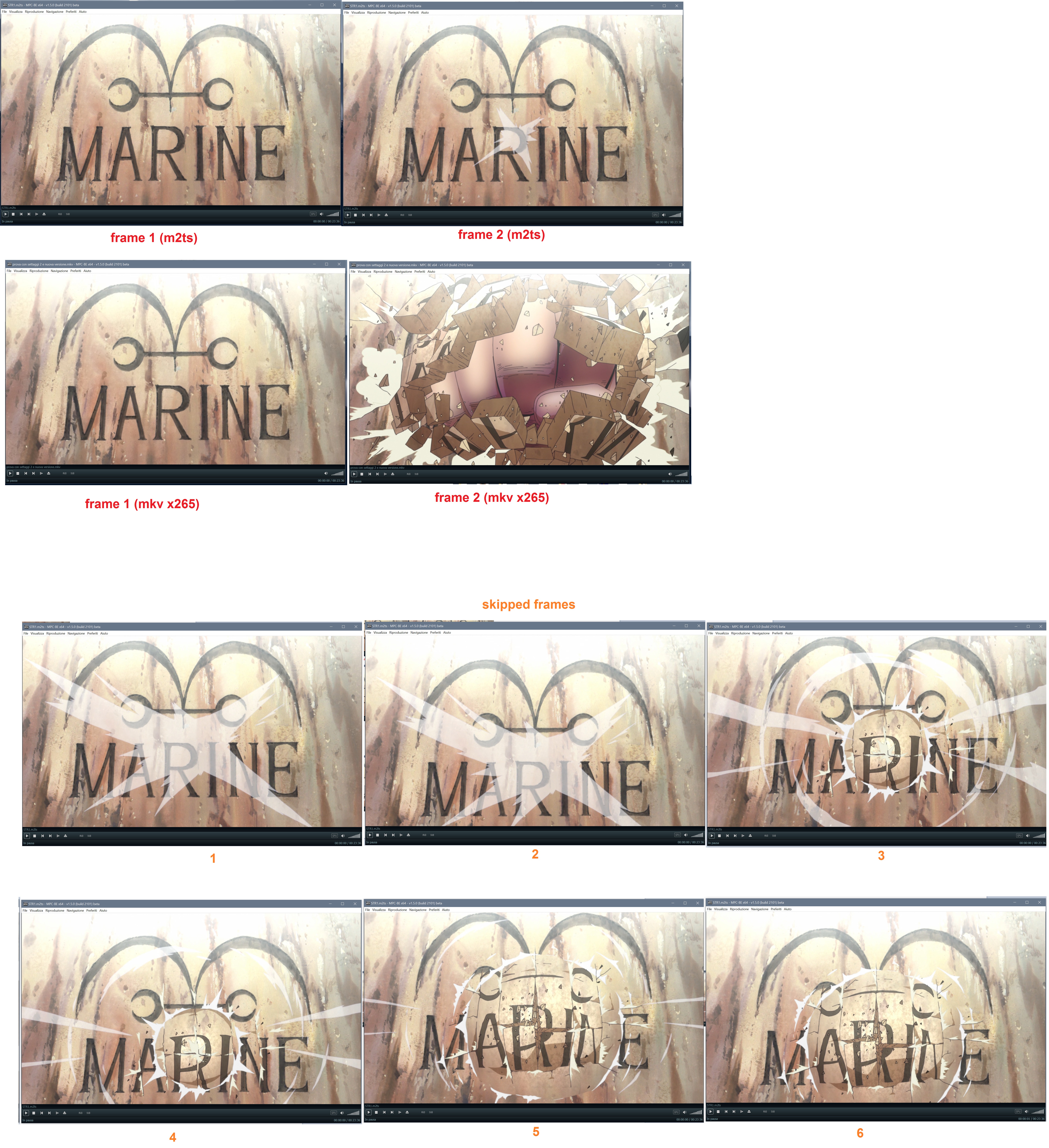

    The problem is still there. I also noticed that every try the video freezes in a different way if that matter, I mean, it's always in the first few frames at the beginning, but it randomly lasts longer or shorter (± 3-4 frames)
    Should I try to use gpu for decoding? (gtx 980)
    (Now i'm also downloading the newest version of hybrid)
    edit:

  13. It's indeed an error of the source filter (ffms2). Go "Filtering">"Avisynth">"Misc" and tick "LibavVideoSource instead of FFmpegSource". (Or another method like DGDecodeNV as suggested by Dougster.)
