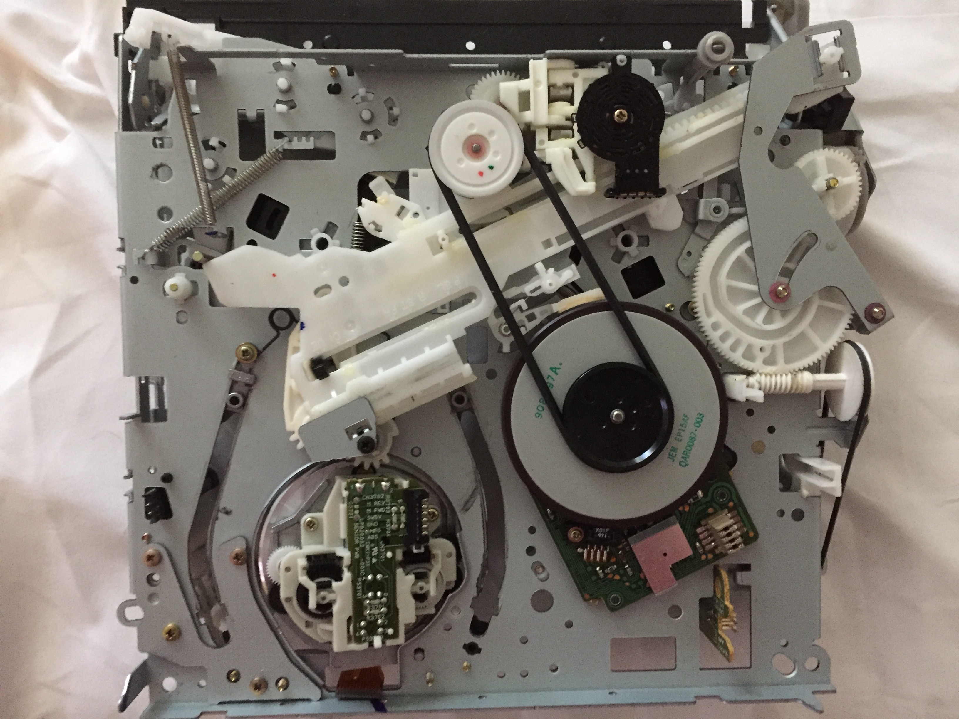

  3. Welp cleaning the mode switch didn't work. Maybe it needs more cleaning? I attached a pic of the insides. Wish there is a transparent VHS clam shell for sale so I can see the mechanisms at work.
    Edit: Looks like the braking pad has worn out. I'm trying to use a heavy duty foam tape as a replacement.

    Check the tension band on the supply spindle. If it is worn, dirty, or loose, the spindle coasts to a stop and spills tape. On some VCRs, there is a separate brake that you should check as well.

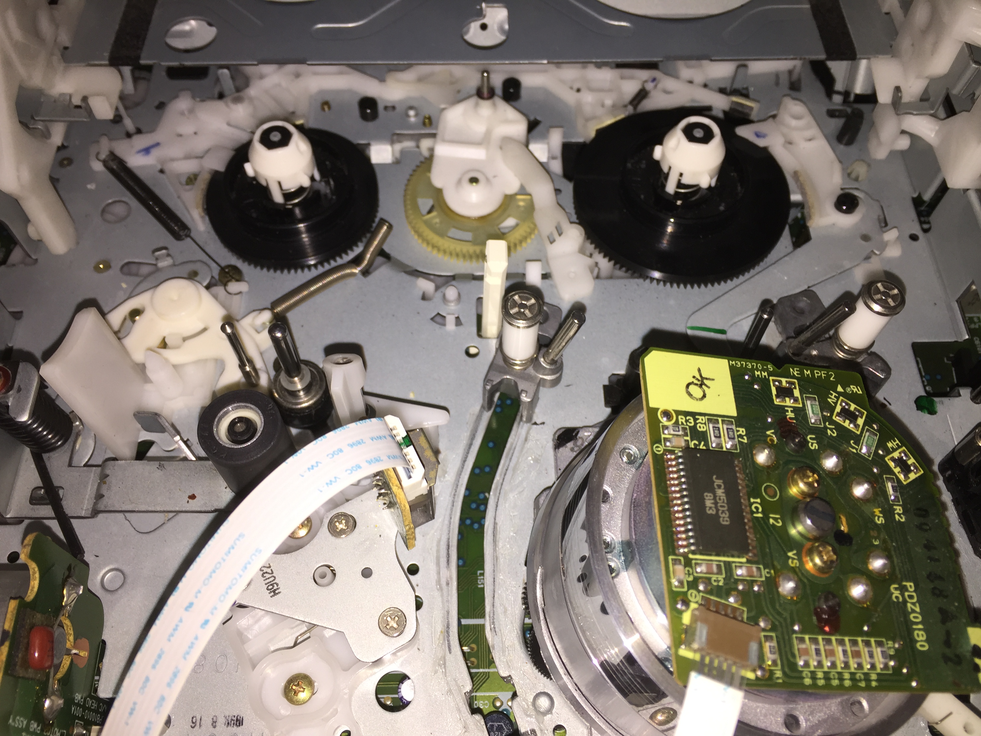

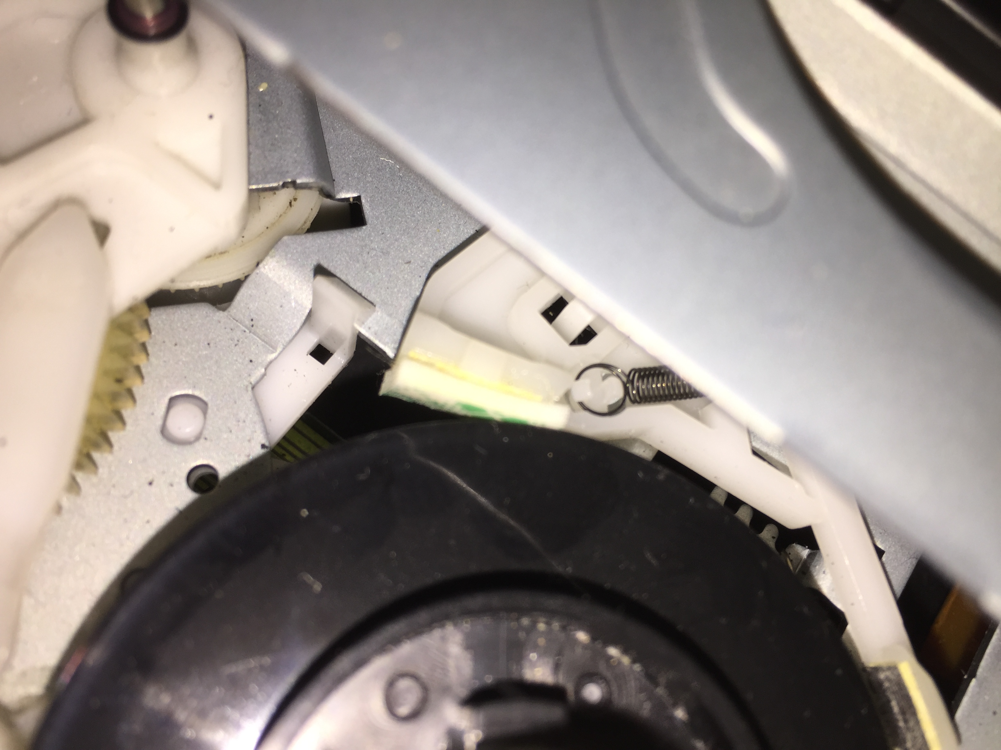

  5. There are only 2 belts and they look and feel fine. What I did that partially fix the problem is stick a foam tape on the supply reel brake pad. It doesn't stop immediately but does it in about a second, fast enough it doesn't eat tapes. I'm gonna get sandpaper and stick it there for more friction.
