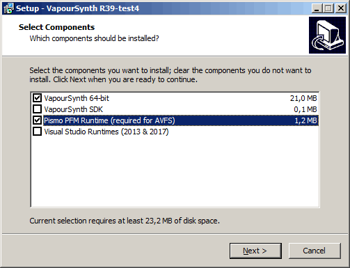

  25. I don't know why that error happens.
    Try: simple AviSynth script with just "version()". Test if it loads in AviSyth.
    Did you activate Pismo during VapourSynth installation?
    [Attachment 43084 - Click to enlarge]
