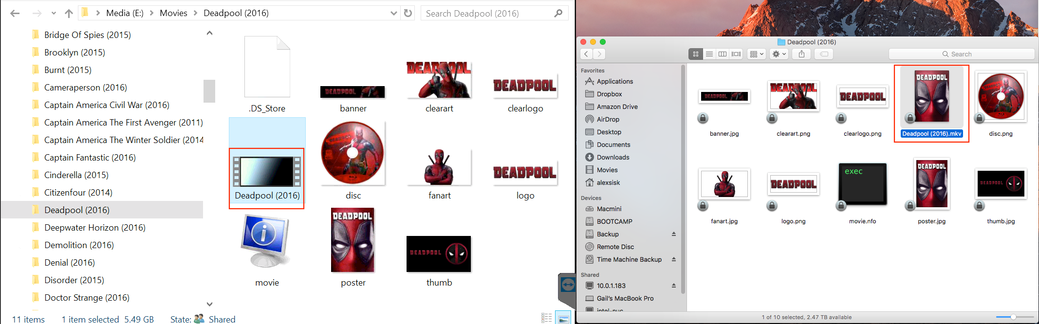

Same path / file viewed from my Win10 Pro (via TeamViewer for easy sreenshot) machine & macOS machine. Attached poster.jpg (though I usually rename it cover.jpg). This is what I get from Win vs Mac. I use Windows regularly, but more things just work automatically on macOS - plain and simple. I would like it to appear the same way in Windows as well....but oh well.
[Attachment 40871 - Click to enlarge] -
