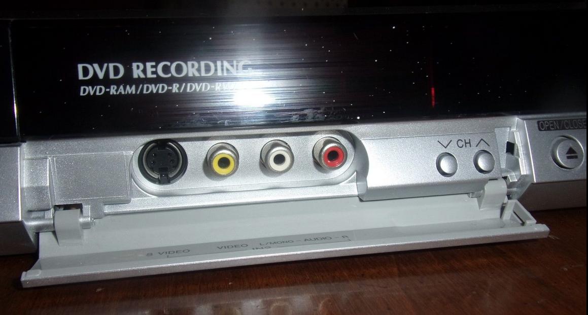

  7. Originally Posted by harky View Post
    actually i only use S-Video so there is only 1 input.
    There are two. One in the back and another in the front. I'll enclose a picture. I'm not saying that's going to magically make the TBC work, but only that you should try it.
