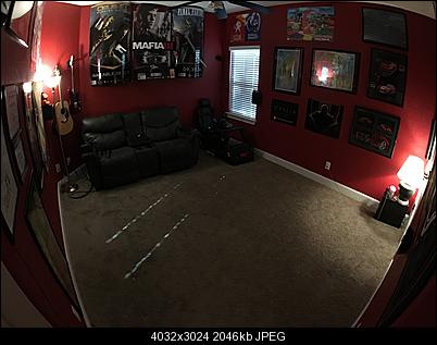

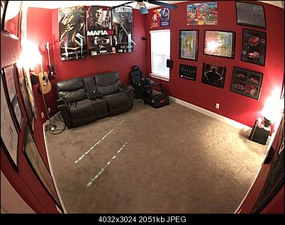

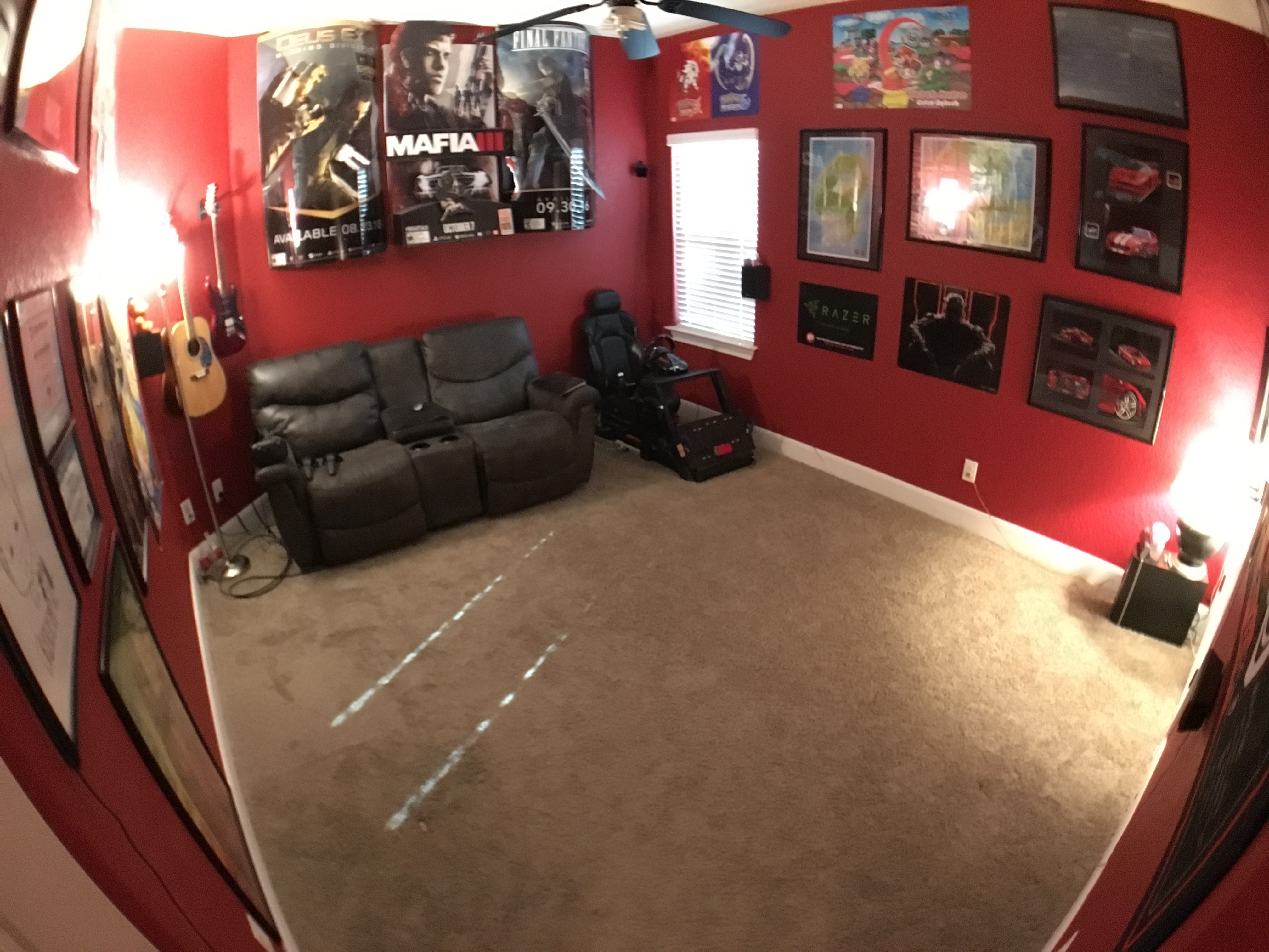

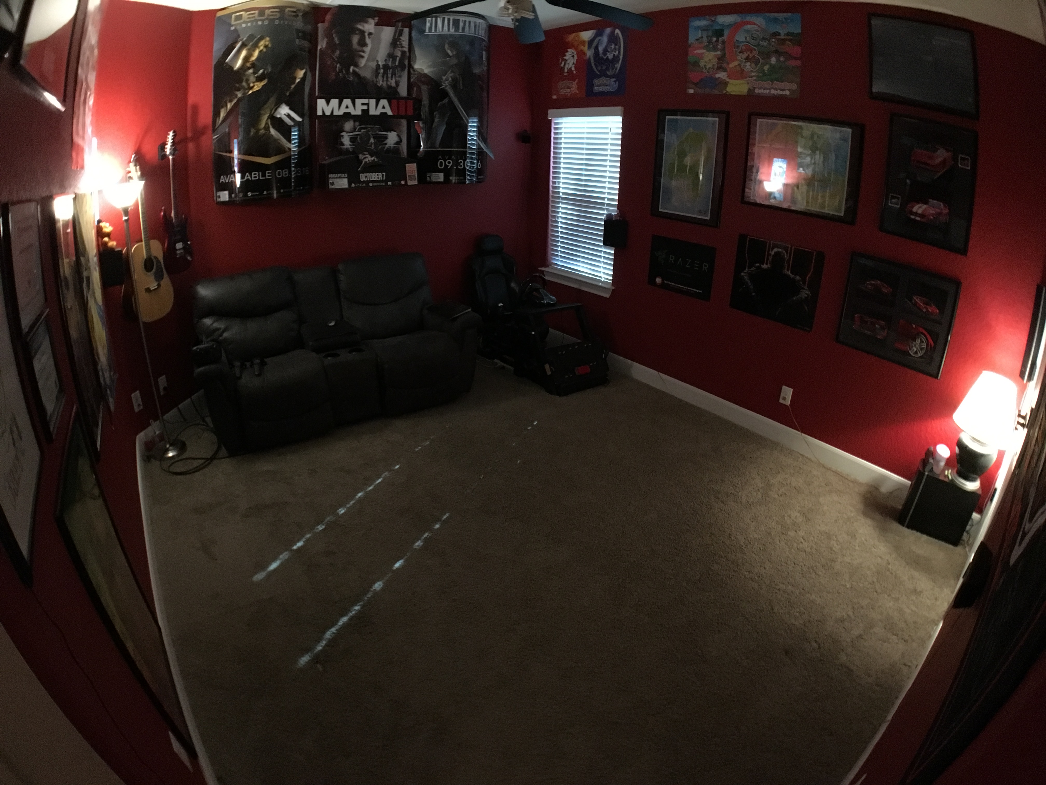

    Hello all! I have just started my journey to become a content creator for Level 2 VR to help get them on the map of VR gaming and have a good 16'x16' room as a good base to turn into a recording studio but the one thing that really makes or breaks the video quality which is lighting and that is something I don't currently have yet but am actively researching on what to buy and where to place. I heard having lighting up top in the middle like where most rooms have their ceiling fan isn't a good place because of the downward shadows it creates so I'm trying to figure out what lights I need, how many, and where to place them. Here is a picture of the room:
    Yes the first picture of the room looks nice and bright after jacking up the brightness on the camera for pictures but unfortunately the same can't be done with videos and for videos looks more like the second picture. The placement of the lamps I think are good but of course actual studio lighting instead of those two little lamps and probably celing mounted and that is where I need your guys help! What lights should I buy? I know enough about lighting placement as to get a nice evenly spread out effect with no hotspots which is why I have my lamps in the corners but what could I replace the lamps with that are mountable on the ceiling of if the ceiling isn't a good place to mount, where should I mount recommended studio lighting?
