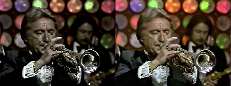

    A particular video I'm working on doesn't look the same when played off Blu-Ray to a 1080p HDTV as it does played on a 1080p computer monitor. It's upscaled SD but I don't think the difference can be explained just due to being viewed at a larger size. Using an LG Blu-Ray player going to the tv via HDMI.
    Where it's really noticeable is on longer shots - when viewed on the TV off Blu-Ray it takes on a sort of "Impressionist" blotchiness. On the computer monitor while obviously there's no more detail there's at least a smoothness to the image even when zoomed in - which is why I think the issue is something other than just being viewed larger on the tv. It's not a high-dollar tv but commercial Blu-Ray, homemade HD video Blu-Ray, OTA HD broadcasts, retro-TV channels that broadcast SD shows, commercial DVD that's been encoded with enough bitrate, video games all look fine on the tv.
    Playing the raw m2t file through the Blu-Ray player has the same issue. Progressive or interlaced no difference. Upscaled to 720 or 1080 same. Using what I'm sure is an overkill bitrate - 20mbps. The file started as a VHS capture to DVD I got from someone else. De-noised with Neat Video, deinterlaced with QTGMC, upscaled with Avisynth Lanczos4resize, rendered as m2t in Vegas Pro 9.
    Since I can't screen shot what it looks like on the TV on my end, I'm including a link to a short 29 meg sample m2t you can burn to disk and see if you get the same results. Both a distant and closeup shot. The closeup shot of the trumpet player looks decent, the more distant shot of the band is where the problem is really obvious.
    960 x 720 m2t file:
    https://drive.google.com/file/d/0B0zvAZXgfLgiOFhPcUotVDZmakk/view?usp=sharing
    Is there some fundamental difference in how the Blu-Ray player and/or TV handles the file vs. the computer? What if anything can I do to make it look the same on the TV as it does on the monitor?
    Thanks for all input.

  3. In terms of the file itself, the levels are "illegal" full range 0-255 . This might have something to do with the discrepancy but that should be fixed eitherway . Different equipment handle "illegal" levels slightly differently . Perhaps one or more of your display setups are not calibrated correctly or at least differently
    Also it would need to be pillarboxed for authored BD, but not as a file for playback (from usb)
  4. Levels are wrong, it's been poorly bob deinterlaced, too much noise reduction has been applied, and colors are washed out. It probably should have looked more like this (original on the left, adjusted on the right):
    [Attachment 40101 - Click to enlarge]
    As to why it looks different on your TV, TVs are usually set up to increase contrast, saturate colors, reduce noise, and sharpen the picture -- because that caricature sells in the showroom. If you go through the controls on your TV and turn off all those over-processing filters the picture will look a lot like your computer monitor (assuming both are otherwise not set too far out of whack, and neither your blu-ray player, graphics card, or media player is set up incorrectly).
    It was deinterlaced with QTGMC.
    What are you seeing that leads you to say it was poorly deinterlaced?
    The levels on the TV are set middle of the road - I played with them somewhat but nothing made a difference in the fundamental issue described above. Haven't done any setup on the player, I'm not aware of what setup is even possible on it.

    First of all, why did you not upload the original video? You've complicated matters by reencoding. Nobody can say for sure what problems were in the original BD video and what problems you created.
    Because the picture is bouncing up and down with each frame. It looks to me like the original source was 480i and it was bob deinterlaced then reencoded as interlaced 1080i on the BD. Then you deinterlaced with QTGMC and downscaled to 720p.
    You're looking in the wrong place. Find the settings for things like auto brightness, contrast, color, skin tone, noise reduction, etc. Turn all those automatic adjustments off. All they do is screw up the picture.
    Maybe the firmware decoder in your Blu-ray player doesn't do as good a job as the software decoder in your computer. Or maybe it's the TV. I would try playing the file from your computer to the TV.

    Going back to the original VOB file as per the link above and applying this deinterlace script
    SetMemoryMax(1024)
    SetMTMode(3,4)
    FFMpegSource2("W:\sourcefile.VOB")
    SetMTMode(2)
    AssumeTFF()
    ConvertToYV12()
    QTGMC(Preset="slow")
    I see the frame to frame image bounce when scrolling in Virtualdub. MediaInfo confirms the file is TFF. I assumed it's related to the offset of the fields.
    I can make it stop doing it by adding
    SelectEven()
    convertfps(59.94)
    As I understand it this retains half the original fields and creates interpolated fields that aren't offset. Is it possible to retain all the original fields and still eliminate the bounce? Is there a reason to care about retaining the original fields?
    My reason for deinterlacing in the first place would be to either to create progressive video or to facilitate cropping without screwing up the interlacing, going back to interlaced after cropping.

    You should use ConvertToYV12(interlaced=true) instead of just ConvertToYV12(). But I don't think that's causing your bounce. And I would use DgIndex/Mpeg2Source instead of ffmpeg. It's much more reliable for DVD MPEG 2.
    I wouldn't blindly trust MediaInfo. Use your own eyes. The result from QTGMC() appears to confirm it's TFF. Though, with the bounce problem, I'm not sure I'd trust that either.
    Yes, but QTGMC() is supposed to "fix" the bounce. It's not clear why it isn't doing so here. The sample you have provided is too far away from the source to give adequate analysis.
    SelectEven()
    convertfps(59.94)
    It produces blended frames between the remaining original frames. The blended frames look very blurry when there is motion -- as they are basically double exposures. I'd probably use ConvertFPS (exact duplicates, jerky but maybe acceptable) or motion interpolation instead.
    There is something unusual going on here. You'll have to upload a short segment of your original MPEG 2 video (not re-encoded) for analysis.
    You'll get smoother motion.

    What I've ended up doing is starting over with this particular file. Went back to the original DVD but redid how I'm reinterlacing it since Jagabo brought up the issue with the image bouncing. Also being conscious of frame order and specifying exact frame rates - i.e. 59.94 instead of 60, etc. One thing I have learned is there can be a narrow path to getting it right - forget or be unaware of one parameter change on one app in the chain and the whole thing can be screwed up. I'll see if it looks better on the tv.

    Cool. Now if we can convince the O.P. yo dyop wrecking the aspect ratio by6 stretching the 9mqge horizontally....
    That stretch put 40 pounds onto Doc Severinsen and turned those lighted background circles into ovals. Those were dead giveaways that the image proportions were distorted.
    - My sister Ann's brother

    I didn't get a bounce from the VOB and QTGMC. Maybe because I demuxed the thing first ? (NIC audio gave me an error about missing header info in the audio track). Maybe. But don't you think Doc looks better at his natural weight without his head stretched out, and those lights in the background should be circles, not eggs. Maybe something like the attached mp4. I didn't do all the denoising, just QTGMC. But cropping off the sides and then stretching the results out to 960 is, uh, well, looks a little strange, like a processing mistake, don't it?
    Cut off the stuff on the borders you didn't want, and then crop off the bottom and top noise, gives you a 662x468 image:
    Crop(22,2,-36,-10) #image is 662x468
    The aspect ratio of that image if displayed as "4:3" won't be 1.3333:1, it would be about 1.2906:1. To upsize that to 720p square pixels and keep the same image ratio so that the humans could recognize themselves would be a resize to 930x720. Then add the side pixels to give you the regulation frame size for 1280x720 @60p (and don't forget the color matrix):
    Spline36Resize(928,720).AddBorders(176,0,176,0)
    ColorMatrix(mode="Rec.601->Rec.709")
