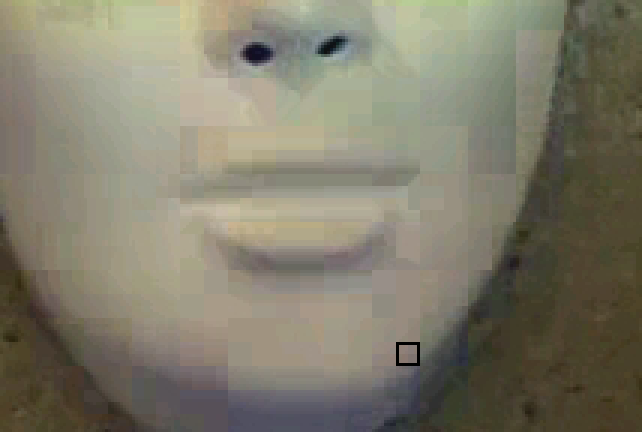

    Whenever there's too much going on, the video will show blocks, what I think are 8x8 blocks, when I encode my DVD, even with low settings these blocks never show. What can I do to create a similar effect? I just want to know what causes it, how can it be avoided, and does avoiding it decrease decoding performance(if using software decoding)
    Zoomed and highlighted one of the blocks.

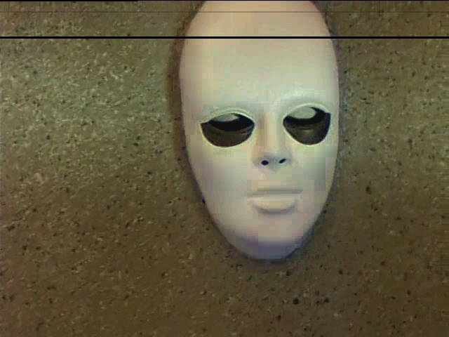

    This is during a slight pan, after a few seconds the blocks simply vanish but usually if the scene continues to be too detailed, grainy, or whatever, they will form again.
    All I know about the streamed video is that it's 640x480, h264 baseline, 29.97, 1300 kbps, and that their 24 fps videos don't share this problem... from what I can tell anyway.
    If you want to create these artifacts, use a low bitrate, single pass, with low complexity settings (ultra fast preset in x264 e.g.). Using a higher bitrate and more complex settings will decrease decoding performance.
