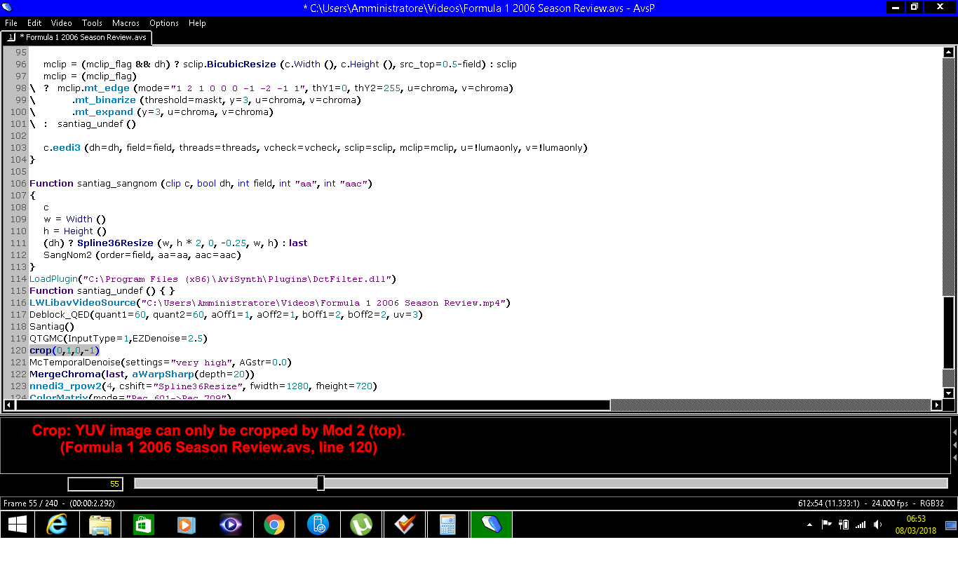

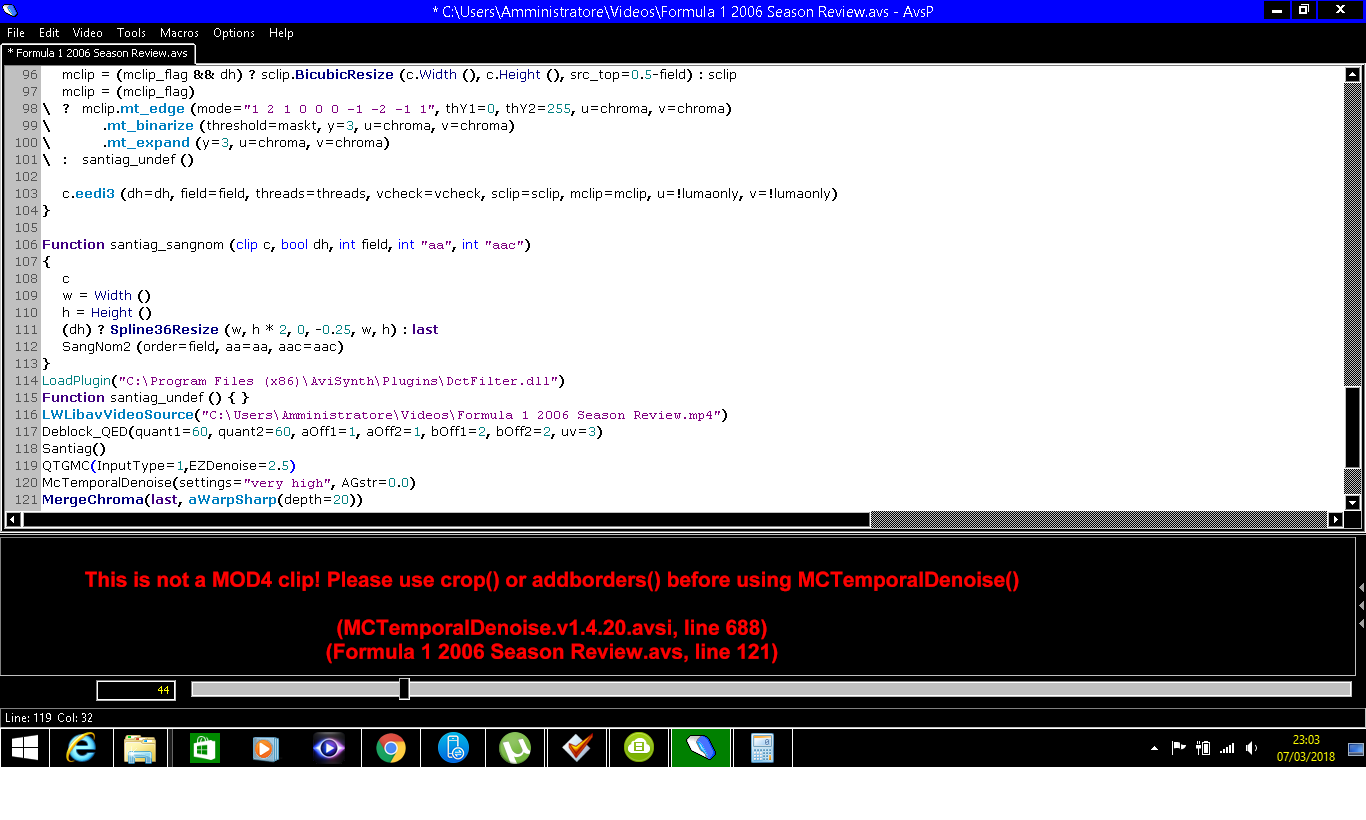

  11. It's telling you exactly what's wrong and how to fix it. Mod4 = integer multiple of 4. For example, 4, 8, 12, 16, 20...
  12. Maybe if you used your head you'd see. Look at that line 120 and you see you're cropping by 1. That's a serious no-no in AviSynth unless you're in RGB. It doesn't mean the resulting resolution has to be Mod2, but the individual crops themselves have to be Mod2 (multiples of 2).

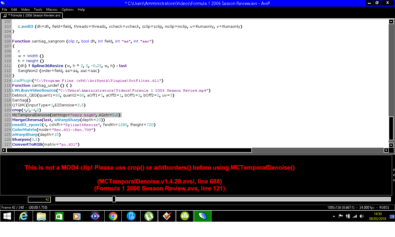

  13. Can you explain what the hell I should do? The video is in 426x240 resolution, how do I make it compatible with MOD4?Image
    [Attachment 44864 - Click to enlarge]
  14. If you need to reduce the width by 2, and can't crop each edge by 1, what else can you do?
  15. Originally Posted by ciccioschumacher View Post
    What I do in such situations is use AddBorders to add 2 more so it's Mod4 and then remove those 2 pixels after the filtering with a Crop line.
    AddBorders(2,0,0,0)
    Filter
    Crop(2,0,0,0)
