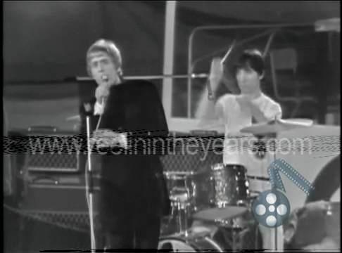

  7. Here's an example of what I see when it messes up:
    [Attachment 40509 - Click to enlarge]
    I noticed the video has a mod 2 (486) frame width. But changing it to 480 didn't help.
  8. Yeah, same thing here. And I tried making it Mod4 (488 using AddBorders) and discovered it changed nothing.
    But I'm not going to lose any sleep over it as I have enough screwed up projects of my own to keep me busy.

  12. You can reduce the logo a bit more by preparing a better logo image with a more perfect black background and more even brightness. You may have to adjust the logo's ColorYUV(gain_y=-45) a bit to compensate.
    You can also blur the area of the logo a bit to reduce the remaining garbage. Add these two lines after NoLogoAuto():
    logomask = mt_binarize(logo.ConvertToYV12(), 40).mt_expand().Blur(1.0).ConvertToYUY2()
    Overlay(last, last.Blur(1.0), mask=logomask)
    The picture isn't very sharp to begin with so blurring it a bit around the logo doesn't hurt much.
    You may need to adjust the mt_binarize() threshold (40 here) depending on the logo image you use.

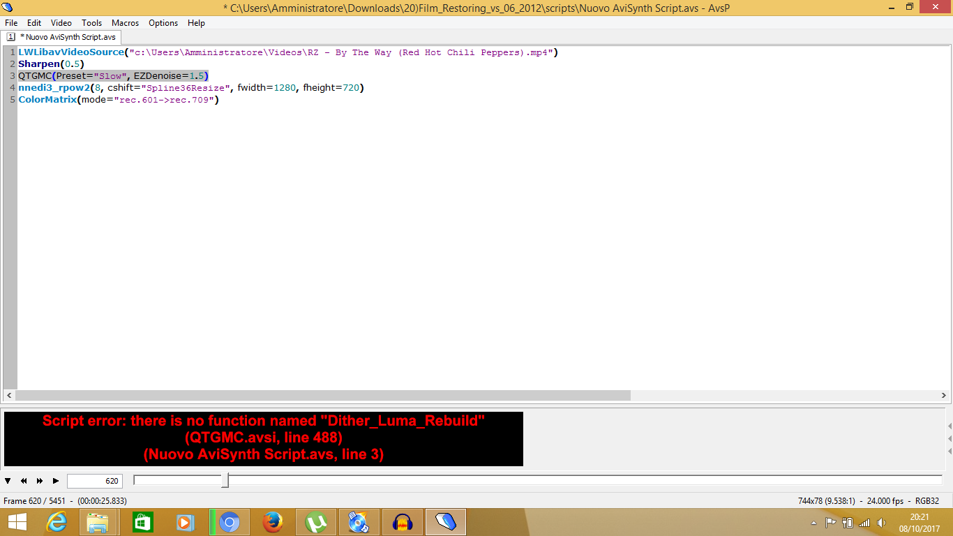

  23. Wherever you got your QTGMC, there's a needed dither package or some other filter you never grabbed. Try and go back to where you got QTGMC and check for the other filters needed to make it work. It may only be needed for the EZDenoise setting.
