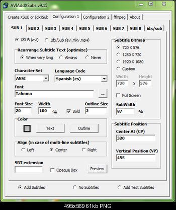

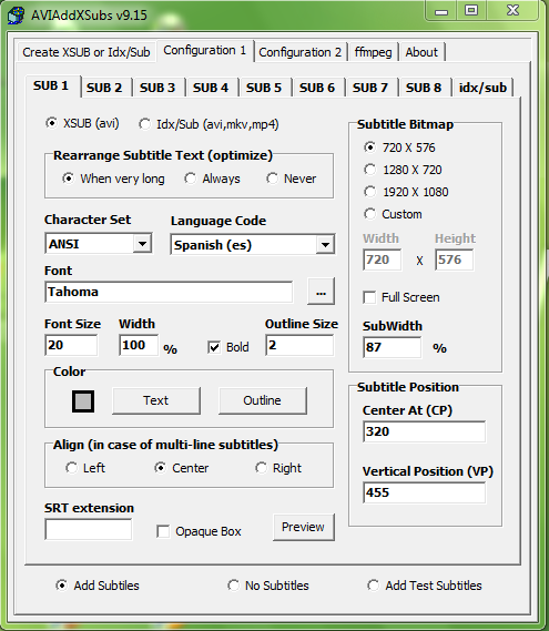

	This is the correct setting for .avi videos up to 720x576.
 A 624x352 resolution is within that range.
 Any adjustments to the font size should be made in the Font Size box.
 Of course, my language is Spanish. You must also change the language in the Language Code box.
 Another song is VLC. I do not know how it's going to look.
 I do not use that software. Try it yourself.Last edited by remanyao; 23rd Dec 2016 at 10:07.
