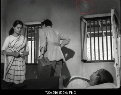

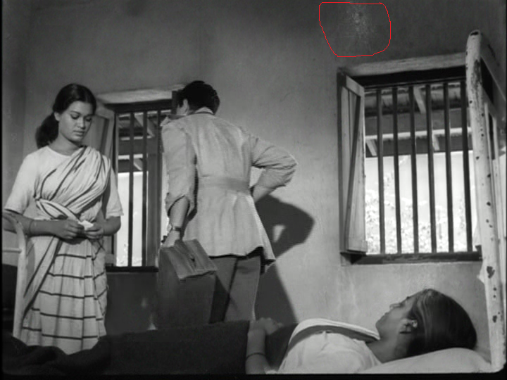

    Hello!
    I need to remove these white spots in this DVD. I tried "RemoveSpotsMC2x" but didn't remove it, any idea?
    LoadPlugin("C:\Program Files (x86)\AviSynth\plugins\DGDecode.dll")
    LoadPlugin("C:\Program Files (x86)\AviSynth\plugins\mt-masktools-25.dll")
    LoadPlugin("C:\Program Files (x86)\AviSynth\plugins\mvtools2.dll")
    LoadPlugin("C:\Program Files (x86)\AviSynth\plugins\nnedi3.dll")
    LoadPlugin("C:\Program Files (x86)\AviSynth\plugins\RemoveDirtS.dll")
    LoadPlugin("C:\Program Files (x86)\AviSynth\plugins\RemoveGrainS.dll")
    LoadPlugin("C:\Program Files (x86)\AviSynth\plugins\RepairSSE2.dll")
    LoadPlugin("C:\Program Files (x86)\AviSynth\plugins\masktools2.dll")
    LoadPlugin("C:\Program Files (x86)\AviSynth\plugins\RgTools.dll")
    Import("C:\Program Files (x86)\AviSynth\plugins\Srestore.avs")
    Import("C:\Program Files (x86)\AviSynth\plugins\RemoveSpotsMC.avs")
    Import("C:\Program Files (x86)\AviSynth\plugins\QTGMC-3.32.avs")
    SetMTMode(5, 3)
    SetMemoryMax(512)
    MPEG2Source("D:\VIDEO\VIDEO_TS\Test01.d2v", cpu=0)
    SetMTMode(2)
    AssumeTFF()
    QTGMC( Preset="Fast", Sharpness=0.3, EdiThreads=1)
    Srestore(frate=25)
    AssumeFPS(23.976)
    Greyscale()
    a=last
    e=a.SelectEven().RemoveSpotsMC2x()
    o=a.SelectOdd().RemoveSpotsMC2x()
    Interleave(e,o)
    Crop(2, 0, -2, -8)
  2. Maybe it's too big for RemoveSpotsMC. RemoveDirtMC gets rid of it:
    MPEG2Source("test.d2v")
    QTGMC()
    Srestore()
    RemoveDirtMC(last, 55, false)
    I forget what it needs besides the function itself. Probably the same as RemoveSpotsMC. The error message will tell you. Here's the function:

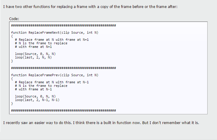

    I have two other functions for replacing a frame with a copy of the frame before or the frame after:
    function ReplaceFrameNext(clip Source, int N)
      # Replace frame at N with frame at N+1
      # N is the frame to replace
      # with frame at N+1
      loop(Source, 0, N, N)
      loop(last, 2, N, N)
    function ReplaceFramePrev(clip Source, int N)
      # Replace frame at N with frame at N-1
      # with frame at N-1
      loop(last, 2, N-1, N-1)
    I recently saw an easier way to do this. I think there is a built in function now. But I don't remember what it is.

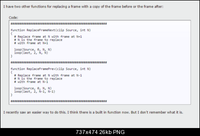

    Also, How can I call this code :
    Thank you!
  9. Originally Posted by TeNSoR View Post
    Excuse me, jagabo, Can I put these codes together or just one of them
    ReplaceFramesMC(100) # replace frame 100
    ReplaceFramesMC(205,3) # replace three consecutive frames: 205, 206, and 207
    You can call the function as many times as needed.
    [Attachment 40037 - Click to enlarge]
    As with any AviSynth function, include them in the body of your code, or save them as an AVS file and import them into your script, or save them as an AVSI file in AviSyth's plugins folder and they'll automatically import every time AviSynth is started. Then call them with:
    ReplaceFrameNext(123) # replace frame 123 with a copy of frame 124
    ReplaceFramePrev(234) # replace frame 234 with a copy of frame 233
    Call them as many times as needed.
