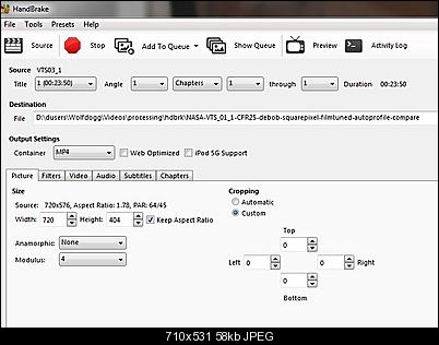

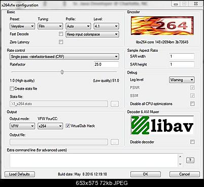

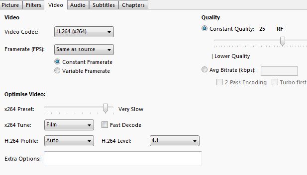

    HB being Handbrake;

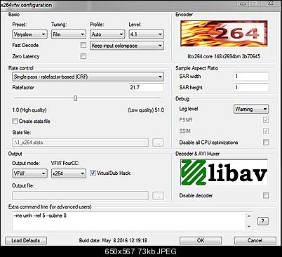

    I'm trying to mimic hb settings, so i have this param list that i would like to use in vdub, which are being fussy.
    Can someone speculate, or know if there's a version for VFW that might work so i can get these options run, on vdub x264vfw compression? Since i love vdub so much, i feel i have an understanding enough to help make that contribution to those who try to keep vdub at its best tune. So im trying to figure this out.

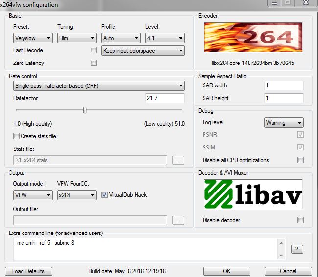

    What IS working in vdub
    --me umh --ref 5 --subme 8
    Whats not working in vdub x264vfw
    --b_adapt 2
    --direct 3
    --rc_lookahead 50
    And ones that may not be compatible yet, but would like to use also
    --cplxblur 20.0
    --qblur 0.5
    --vbv_maxrate 62500
    --vbv_bufsize 78125
    --nal_hrd none
    --filler 0
    It wont encode on profile 'high' either, so im having to set that to auto. (notice the settings, especially the "Extra command line (for advanced users)" input box on the bottom.

  3. x264 parameters don't use the underscore
    for example it should be --b-adapt 2 instead of --b_adapt 2
    But that doesn't do anything extra because the --preset veryslow already implies --b-adapt 2, same with --direct auto , but --rc-lookahead is 60 for veryslow , so if you changed it to 50 that would deviate from the preset
    komisar's x264vfw gui has more checkboxes, but it's not updated as often

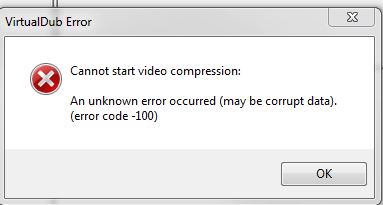

  7. Member wolfdogg's Avatar
    May 2011
    Portland, OR, USA
    well i think the difficulty is to get all the settings to work, for example, right now its saying '--direct=3' is not a valid parameter , when im passing it in like this '--direct 3'
    I just updated to the Komisars fix, not seeing any difference on the gui, was hoping to see some more checkmarks, all the same, might have had latest version already or something. unless im missing something.
    Not knowing which vob HB is pulling from, i cant get a correct comparison yet, but yeah, im narrowing it down, if i can get most of these setting to work, however, its the AVI container. Your saying you believe the avi (using vdub) contain, and mp4 container (using hb) should contain same quality pixel if both were encoded the same? thats what im trying to find out.

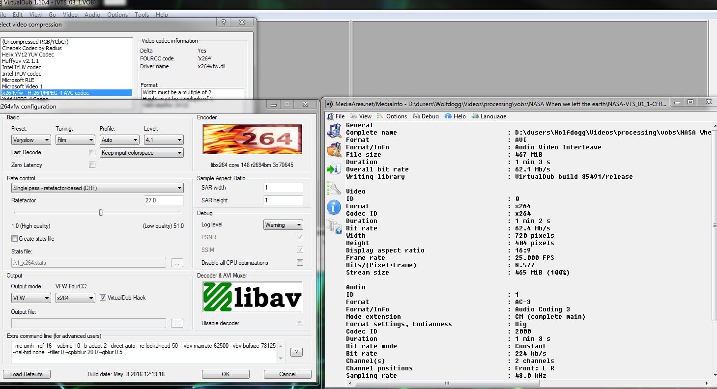

    params in vdub
    --me umh --ref 5 --subme 8 --b-adapt 2 --direct 3 --rc-lookahead 50
    error vdub gives me this time, after komisars fix, BECAUSE of using the --direct 3 switch. so it breaks before and after the fix, i think the error message just is more cryptic now. But i have seen this one too, with wrong params. like it doesnt know what to do with them. wheres the master list for these? i think ill refer to the man site for x264 on that and see if i can dig some more.

  9. I posted screeeshots of komisars vfw GUI in other threads, there are 3 pages/tabs. It's very old (2013) based on older x264 versions , so you might not want to use it. If you are using vdub 32bit, you need x264vfw 32bit. But it definitely works in vdub
    The "master list" is x264 CLI , you can use x264 --fullhelp 1>fullhelp.txt to print a text file of all the switches. There isn't a verbose explanation there, just a list, but the x264 mewiki has a short explanation of what some of them do
    Handbrake is based on a modified x264 library. But switches for CLI applications usually go 0,1,2,3...etc... as short form. So in that example, "3" corresponds to "auto" , which means x264 can choose what is better for that scenario. It can pick and choose, swap back and forth in different sections. It's usually smarter at choosing than you or me. If you "force" it to use spatial or temporal , then almost always there will be some parts that are less efficiently encoded (ie lower quality). Note all the slower presets beyond "medium" use "--direct auto" - so that should already be a big hint as to what yields higher compression /better quality.
    I didn't say --direct auto was "useless" , I said when you use --preset veryslow, it's redundant because it's already already stipulated. When you enter commandline options you only need to enter values that deviate from the selected preset
    x264vfw in the commandline box uses the same syntax as x264cli , not necessarily handbrake's modified syntax. To get the correct syntax look at the fullhelp . That is why --direct auto would work (or none, spatial, temporal , which correspond to 0,1,2) , but not --direct 3 , which would be handbrake only

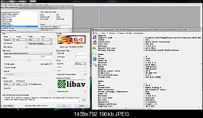

  11. Member wolfdogg's Avatar
    May 2011
    Portland, OR, USA
    its shoddy meaning its coming out piss poor, and way different, wayyy.. ill see if i can grab the mediainfo for them, to help see what i may be doing wrong then. Thats super helpful on the settings breakdown, thats something i was hoping to do next, was just learn about them, but first i wanted to try to mimic them, to see whats going on.
    Ok, heres the video i recently encoded in vdub, with some of the same settings, adding a deinterlace first, then a lancsis reize 2nd, @CRF21.7.
    General
    Complete name                            : D:\dusers\Wolfdogg\Videos\processing\vobs\Flipper (1963) DVD5\VTS_01_1-CFR21.7-dlcd-lnczs-rsz.avi
    Format                                   : AVI
    Format/Info                              : Audio Video Interleave
    File size                                : 928 MiB
    Duration                                 : 25 min 56 s
    Overall bit rate                         : 5 003 kb/s
    Writing library                          : VirtualDub build 35491/release
    Video
    Format                                   : x264
    Codec ID                                 : x264
    Bit rate                                 : 4 801 kb/s
    Width                                    : 704 pixels
    Height                                   : 396 pixels
    Frame rate                               : 25.000 FPS
    Bits/(Pixel*Frame)                       : 0.689
    Stream size                              : 891 MiB (96%)
    notice the bit rate? its much higher than the aimed for 1900kbps. However, would you like to know that this is the shoddy one? it looks wayyy worse than the 1900kbps HB one. i think this was my 2nd full test on this, days after trying some other settings (closer to vdubs best, with no extra params) and had same bad results. Ill have to get a screen compare for of the output video.
    heres the fill string from probably the latest i want to try in vdub(maybe adjusting the crf), and removing the ones that arent vdub compatbile, or already vdub default.

    In order to get the settings in the OP, i made a compatibility chart, and was left with the few i mentioned there, that needed to be passed, as the main differeing vdub/HB params, to get them comparable. Honestly, i thought the vfw just lacked the settings, and they had to be passed in, to achieve the quality that HB has already taken the time to figure out. I mean isnt that what were dealing with here, a vfw that isnt fully developed? or do you think regardless they should still be coming out atleast close?
    screen coming..

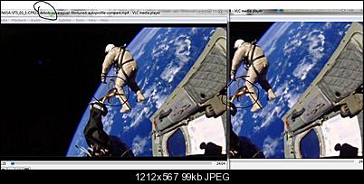

  13. Member wolfdogg's Avatar
    May 2011
    Portland, OR, USA

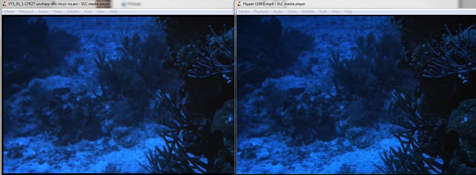

    ok heres the compares, from same bitrate
    [Attachment 40002 - Click to enlarge]
    [Attachment 40003 - Click to enlarge]
    VTS_01_1-CFR27-unsharp-dilc-lnczs-rsz.avi

    i guess this isnt the best example, because the mp4 was 2 pass, and the resize. man thought this was the one. I had another, thats gone, i can do another, but preferably this time all params intact first. I think the thing that struck me here, is look at the bit rate on the avi, why cant it keep up there with picture quality?
  14. 1. Maybe different filter, esp. deinterlacing
    2. Not the same cut (26m vs 1h26m)
  15. Member wolfdogg's Avatar
    May 2011
    Portland, OR, USA
    oh your right about the cut, thats true, on that one, i let HB run them altogether and make one file out of it i think. so maybe it made better encoding? i cant merge them as vobs in dub, have to do them one at a time. You have a great point though. I will definitely have to get more scientific than this, if im going to share that here. So yeah, lets figure out the params, then ill run it again on vdub tonight. So, ill make a full list here once again then, then run a crf27 on both vdub and hb tonight. i use deinterlace bob, interpolate, and hb supposedly used lcsz by default, and im sure it does it after the deinterlace, so i think im getting same result there mostly, or should be atleast, shedding light on the differences. I think i will actually run it with no deinterlace. and a resize to squarepixel off the top, no enhancements obviously.
  16. Resizing without prior deinterlacing will destroy the picture if the content is interlaced.
    I just now also see: the HB encode has 50% more vertical resolution.
  17. Member wolfdogg's Avatar
    May 2011
    Portland, OR, USA
    hmm, was hoping to maintain the sharpness, i guess i forgot about that, since im trying to avoid deinterlace as a newer process to my skillset.
    so ill have to see what you mean, how that affects the encode there about having more vertical res. Also, i got it to take these params so far in vub exactly as is,
    --me umh --ref 16  --subme 10 --b-adapt 2 --direct auto --rc-lookahead 50 --cplxblur 20.0 --qblur 0.5  --vbv-maxrate 62500 --vbv-bufsize 78125 --nal-hrd none  --filler 0 --cplxblur 20.0 --qblur 0.5
    What others can i make and and bring in from the last fill string paste above?
    not sure why, but im getting a 64MB/s file, wanted to be 10GB, using these settings, on a 1gb vob file.
ID:	40004 Its like its sticking with the max all the way, how did HB encode using this vbv-mate rate i wonder. maybe i need to just work out all those settings, to see if i can pass them all, some might depend on others, and i know i cant just leave half them out. this isnt easy.

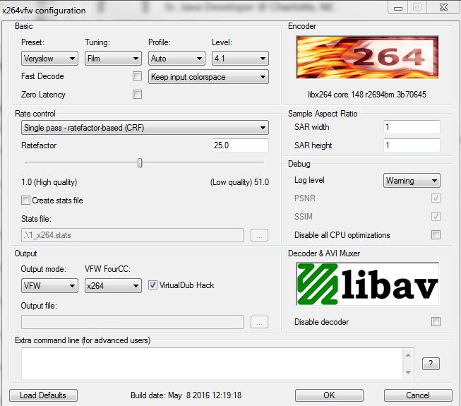

    Well,
    so aside from what i was trying to figure out just above (the params to mimic), here below is the comparison tests i ran last night, that i mentioned i would do.
    Vdub is off the mark, but in size this time, to the high size in fact. So thats different, i didnt expect that.
    This is from the default virtualdub x264vfw with the default settings
Name:	default crf25.JPG

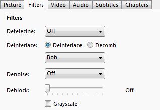

    Name:  vdub filters hb comparison.JPG

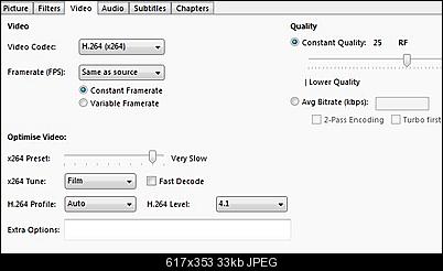

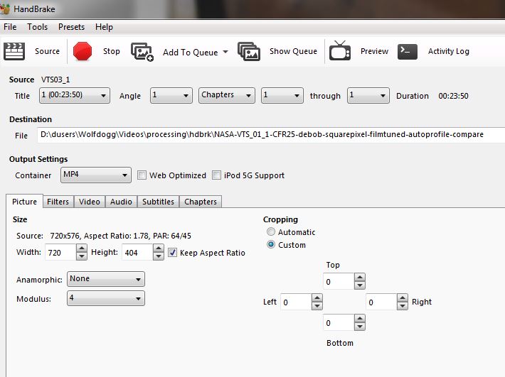

    Then the same equivalent in handbrake

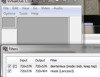

    Tagged date                              : UTC 2016-12-23 09:20:43
    Note, i wanted to use profile high, but VDUB just WONT let me select that option, it complains, compression error. i might have to try different version, im still using that special one i tried from linked here on the boards. (so i used prof-auto)
    I'll grab some quality comparisons hopefully later
    We can see there's a HUGE difference in the way the AVI comes out, for what reason though? Did i make a mistake?
    How can i fine-tune this to get a correct comparison, or is this it? I.E. should i set the crf down in vdub until it yields the same average bit rate as HB? thats like 5 times less though, i know that will blow out the quality completely. What if i bump up the CRF on the HB side, to get it to match the VDUB side, i already did those tests and that answer is CRF21, this file
    1-1-crf21-2223kbps.mp4
    came out to that similar bitrate. its 844MB in size,
    What is the proper colorspace setting in HB, that i should use? did i that right?

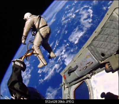

    Heres some cool findings on them too, debob does look better than the slower deinterlace, to me atleast, these are both HB encodes, identical settings, i thought slower would be better, so i used that, the debob was just for the vdub compare, but yeah, go debob.

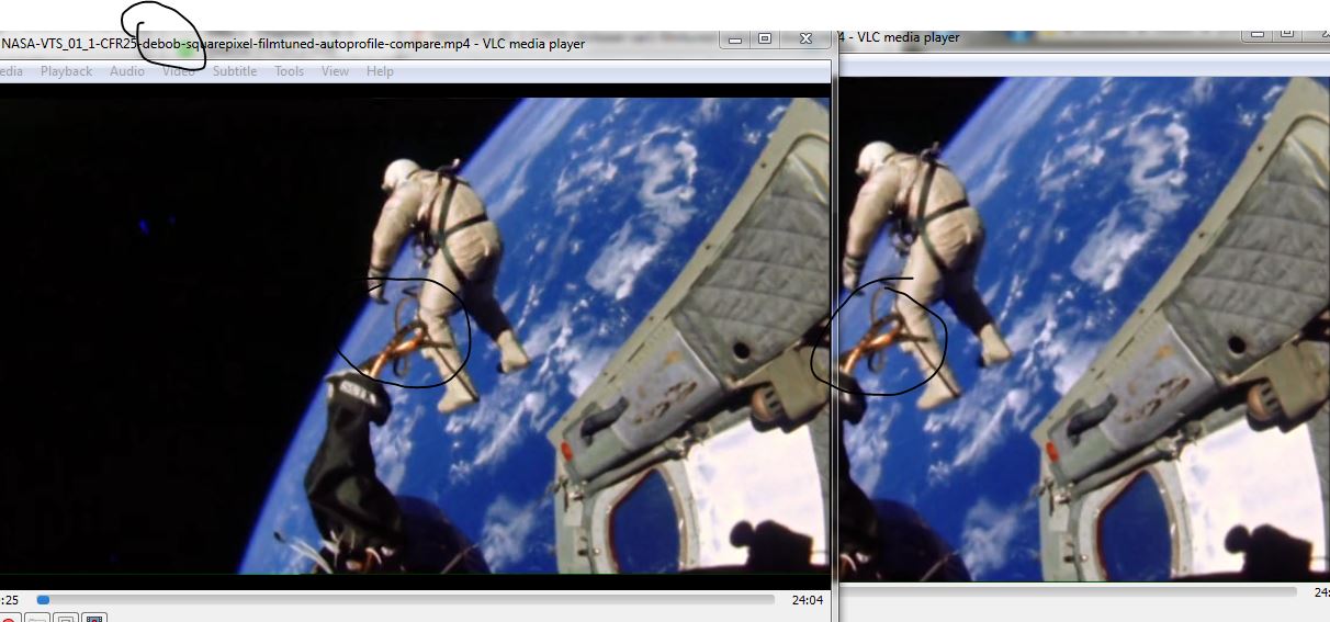

    First the source shot
    then the compressed
Name:	debob better than slower.JPG
    those are 139MB for 24 minutes. nice :-p
  20. Originally Posted by wolfdogg View Post
    Are you getting something like this?
    x264vfw [error]: x264_param_apply_profile failed
    Note it is not vdub`s complaint but x264`s. Simply means some options are incompatible with each other.
    Btw, you have selected "keep input colorspace/format", so do you have an idea what it is, maybe yuv 4:4:4? Try selecting "accept only yuv 4:2:0".

    It was actually the vdub "Compression Error" some code 'maybe', but i see it when error's are generic, leaving no way to backtrace, atleast that i can see. If it has a code, ill definitely get it. ill check here in a bit.
    yeah, my source is 4:2:0, i just wanted to make sure for some ungodly reason that it was supposed to be rgb for final, or something. thats actually what i had it at first("accept only yuv 4:2:0"), thanks for the tip.
    Lastnight's compare encodes are done too, ill get the results here in a bit.
    Edit: your awesome @shekh, so yeah, on one screen i see the VirtualDub Error, "Cannot start video compression: Unknown error occured (may be corrupt data) error code is "-100" yep, there was an error code there, i know this one as pretty generic. And NOW< low and behold, on the other monitor i DO SEE what your saying, "x264vfw log" and sure enough, it does say "param_apply_profile_failed" .
    Ok, so the options im selecting then are maybe incompatible? Yes, i have seen this exact error before using wierd options, however this time i want these settings, what option might be throwing it off? see the screenshot, its everything you see above, except the prof is not auto, its "high", then the error. do you see any other settings that might need to be tweaked, or params i can pass to get these settings in? Im trying to mimic, thats the settings that seemed to worked best in HB, and cant understand why "high" wont work with what seems to be basic settings.
    Good call!

    So this is the error when i tried to switch the prof back to auto, but this time the only difference, i switched colorspace output to Keep/Accept only yuv 4:2:0.
    "unable to initialize video compression.. check video codec is compatible with the output video frame size, and that the settings are correct, or try a different one" thats the one i would normally expect with incorrect settings. So the other one was profile specific, i think i get it now. So i need to know more about high profile then, to see whats its requirements are. Ill look into that. interesting.
    I just also tried the Level Auto, and Tuning none, same error (the latter one), so thats not it. Then switching that to output rgb, i get back to the initial error, as if the rgb colorsace will work with whatever broke the frame size compatibility. So it just doesnt like prof high.

  23. I dont know much about x264 settings, I just saw by experiment that error disappears when input changed from 4:4:4 yuv to 4:2:0 yuv.
  24. check video codec is compatible with the output video frame size
    This means vdub is sending something else other than yuv 420, double check your "output format to encoder" option
  25. Member wolfdogg's Avatar
    May 2011
    Portland, OR, USA
    Ok, in vdub, profile HIGH works when i set it to "Convert" to "yuv 4:2:0".
    The Post above has been updated, for the mediainfo for the virtualdub avi file, using the same source this time, to compare to handbrake, as close as i can get the compare using prof auto, That comparison is now valid. It turns out the file came out exactly the same size, even though the video durations difered by a few seconds, and different content. is that possible? I guess thats what crf does.
    So, with all this, im finding that something is wrong with my settings, if anybody sees, or virtual dub does its best with the codec, placing video data onto an video stream, however is it possible that encoding to mpeg4 container adding all the bvops, gops, b frames, and extra goodies on the stream is what allows to hold the extra quality, or how can they be encoding so different? Obviously if this is real, then the HB is atleast 2 or 3 times more efficient, and and higher quality at a much lower bit rate.
    Should i try to re-encode on handbrake until i get the average bitrate equivalent of the vdub file(2290kbps) to make this more equivalent?
    Output "format"? output mode is VFW of File, and theres the FourCC, and the vdub Hack, are you referring to that output, or the colorspace?
