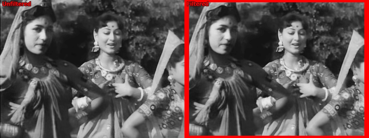

This may not be exactly what you had in mind, but this is another way to filter only the outside borders, but without making it a function:
A=Last
B=BlankClip(A, color = $ff0000)###Filter here, in this case create a red border
A=A.Crop(16,8,-16,-8)###Define the border area
Overlay(B,A,16,8) -
