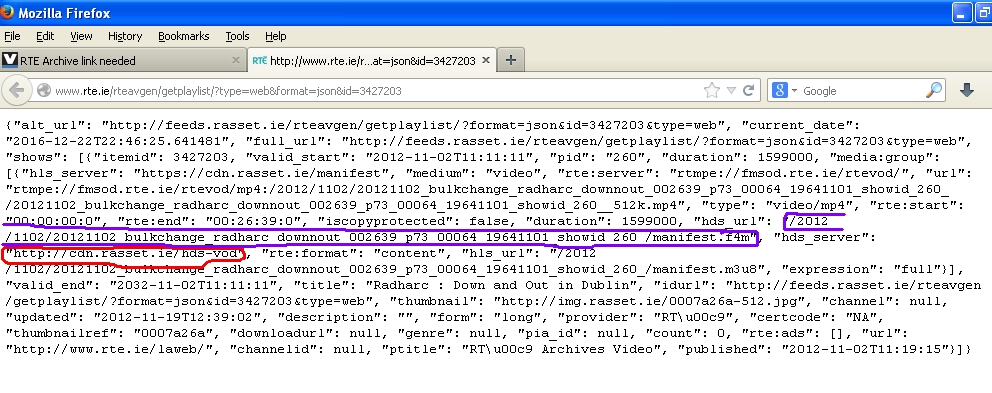

    I was able to download the video from your code no problem. However, how did you get this:
    http://www.rte.ie/rteavgen/getplaylist/?type=web&format=json&id=3427203
    When I put that in Firefox and downloaded it, I got this (see screenshot 1)
    I see in the screenshot, you combined the code in the red and blue circles to get the final code.
    http://cdn.rasset.ie/hds-vod
    /2012/1102/20121102_bulkchange_radharc_downnout_002639_p73_00 064_19641101_showid_260_/manifest.f4m
    How did you know to do that?

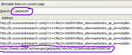

    I played the video with Firefox and used Adblock Plus (see screenshot 2) and got this code only (which is different than yours):
    https://feeds.rasset.ie/rteavgen/getplaylist/?id=3427203&thumbnail=000807a8

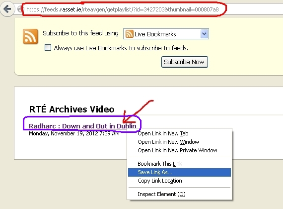

    I put this code in Firefox (see red circle screenshot 3) and saved the link (blue circle).

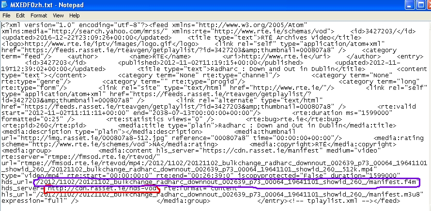

    I got a file and opened in Notepad. The info in this file (although different than your file) also contained the same two parts that you combined to get the final code. (See screenshot 4 red and blue circles.)

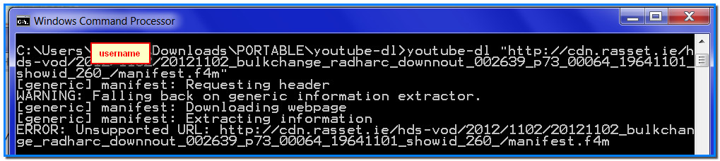

    Thanks for that. The link sysanin gave did not work for me. Could it be because i have youtube dl portable in a sub folder? Why is url unsupported?

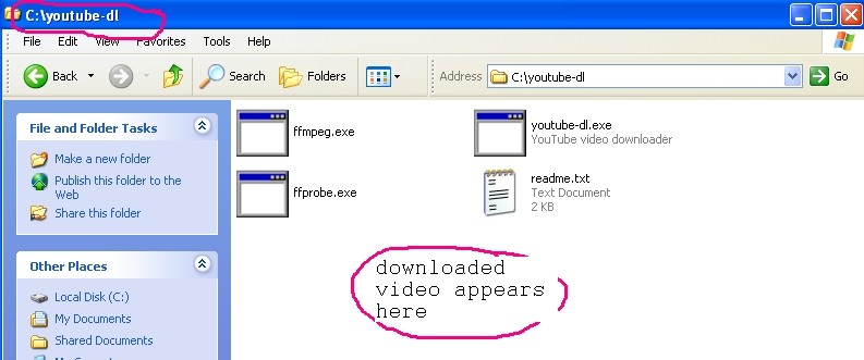

    Try using the youtube-dl here (I place the youtube-dl on the C drive):
    http://files.videohelp.com/u/61125/youtube-dl.zip
    The video that you want should appear in the youtube-dl folder. (see screenshot)
