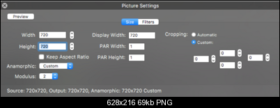

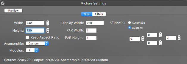

    these are th epicture settings, crop is already set to 0

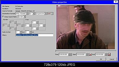

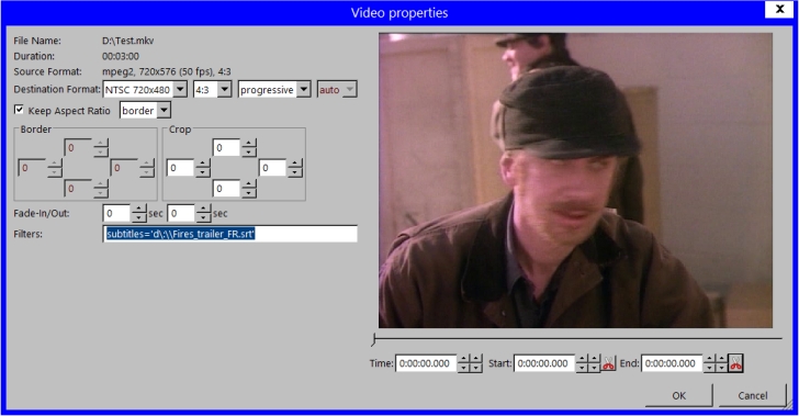

  14. DVDStyler let you make optional (selectable) subs
    i need Handbrake to burn subtitles on it
    but should you want them hardcoded you can use a video filter in DVDStyler
    If your subtitles are .ass replace the "subtitles" filter in the above with "ass"
