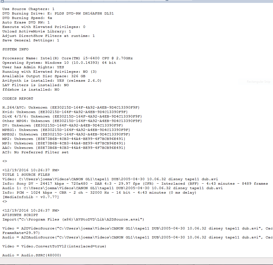

    Thanks for your suggestions. I used VirtualDub to append the files together and it worked fine. There is a small hitch when authoring the result file in AVStoDVD, I am getting error/warning messages "Errors found during Title 1 Audio Track 1 encoding. Audio filesize is too low (0 MB) Backup Audio encoding routine (FFmpeg Safe Mode) is starting..."
    It then seems to run encoding in safe mode. This seems to work and I checked and burned the resulting VIDEO_TS files and they seem OK, they have audio and its in sync. Also seeing a bunch of CODECS Unknown and "AC3: No Preferred Filter set" in the CODECS REPORT on the log. Is this something fairly obvious? Should I have LAV filters downloaded, this is my first attempt at video processing so I am kind of picking my way through. Any suggestions to correct this? Thanks.

    I don't know if this log output would help.

    uploaded entire log
