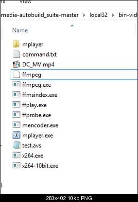

  8. First of all thank you for reply. secondly sorry for delay.
    I build my FFmpeg, and I got a note when I tried to encode in 'yuv420p10le' pixel format, the not is " Incompatible pixel format 'yuv420p10le' for codec 'libx264'" in yellow color
    this is my tools, following my code
    ffmpeg -i "test.avs" -c:v libx264 -pix_fmt yuv420p10le -profile:v high420 -level 4.2 -crf 16 "output.mp4"
    shouldn't come an option with "media-autobuild_suite-master" to build FFmpeg 10bit as well as x264/x265?!
    I just want to use FFmpeg for encoding video & audio at the same time, so i want to know also if it's possible to do a multiple input so I cant encode video with x264 or libx264
    and audio with "-c:a aac" or another audio tool like fdkaac or qaac.
    Thanks in advance

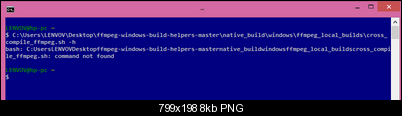

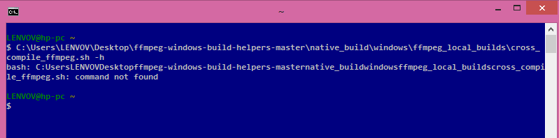

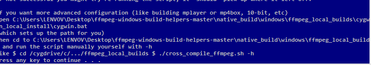

  10. Back again.
    I just finished download and install "build_locally_gpl_32_bit_option"
    after that I got note it says :
    so I followed the instruction, but i got an error "command not found"
    If couldn't complete 10 bit libx264 ffmpeg build, I want try this one if it's possible ..
    ... to do a multiple input so I cant encode video with x264 or libx264 and audio with "-c:a aac" or another audio tool like fdkaac or qaac. at the same time?
