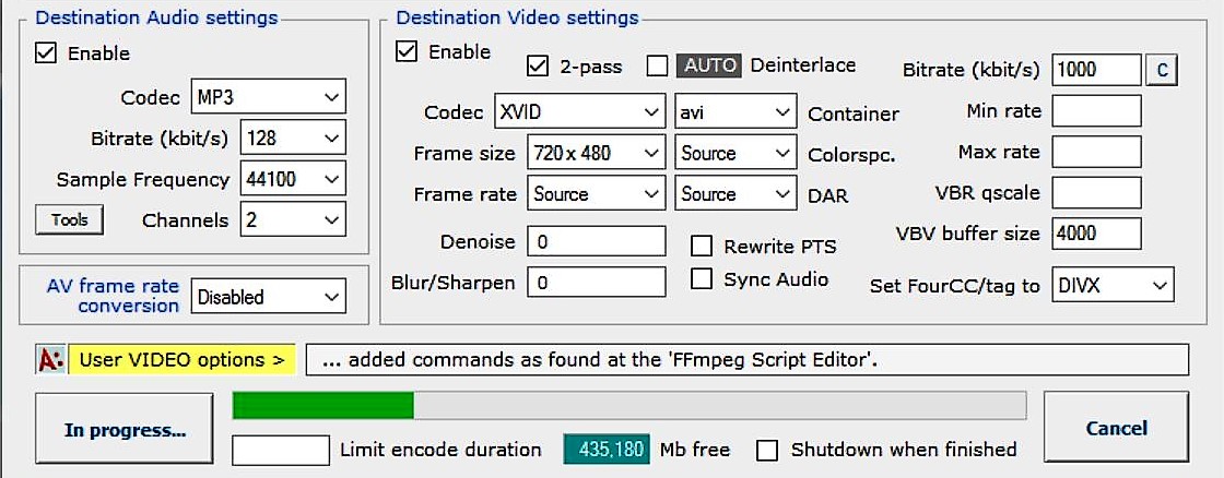

    Could I ask for a bit of help in getting some of your suggested settings set up in AVANTI GUI? Some of the ffmpeg tags are a bit foreign to me and I might not recognize the corresponding field name in the AVANTI GUI. I've included a screenshot of what I've tried for a test run. It seems to work, but I do find the aspect ratio is a bit off (the picture looks a bit compressed in the horizontal direction, but I'm not sure how to correct it even if I know the original files aspect ratio).

  12. My command does not always resize to 720x480. It uses 720x480 as a "box" and tries to fit the picture into it while still retaining square pixels (and mod2 dimensions).
    Example: input is 1920x1080, i.e. 16:9. But 720x480 is 3:2. Then result with my script will be 720x404. If you resize to 720x480 without setting any AR flag to compensate the image will look "compressed" as you say. Actually, I think my script will only work correctly with square pixel input and would need to be further modded in some cases.
    Avanti does not fully run on my Win 7 system but it seems to have a scale/crop setting. In the top there are several icons, it is the 4th from the left. Try to setup the picture there.
    Or maybe you can enter "-vf scale=in_color_matrix=auto:out_color_matrix=bt601: w=720:h=480:force_original_aspect_ratio=decrease,c rop=720:ih-mod(ih\,2)" into the "User VIDEO options" while setting "frame size" to "Source". (Again: I cannot test this.)
