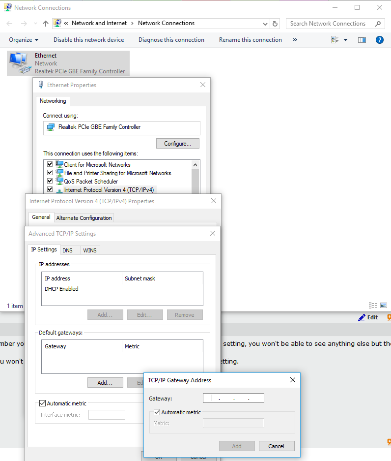

    Thanks Scott but are you saying to follow the instructions below? When I get to the screen where there is an "Add" button high-lighted there is only setting available to change... the Gateway. His instructions says to assign IP address & subnet mask?
    You said to remember the original settings are you talking about my computer's IP address?

    Yeah I do understand about IP addresses but it was the specific procedure on how to change it on my computer is what's tripping me up.
    Specifically on the snapshot I posted where the last screen lets you put in the Gateway is this going to change my computer's IP address? If so then since the camera's IP address is 192.168.1.108 if I enter 192.168.1.109 as the Gateway setting then they should talk to each other correct?

    No. The gateway is a device on the local area network that controls access to another network. Usually, this device is a router connected to the Internet. It provides a service called Dynamic Host Control Protocol (DHCP) which automatically assigns IP addresses to local devices. This is how your computer appears to be configured, with an automatic address. So you need to temporarily add a static address on the same subnet as the camera per mccoady's advice.
