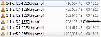

    Originally Posted by "hello_hello
    The player adding black bars to just one side on playback seems a bit odd.
    You were completely right, it was something stupid on my part, good call. My middle monitor (of a 3 wide setup) resolution was, causing the black bars, couldnt tell because the wallpaper had black bars too, when the video played, it just didnt take up the foll monitor, Buah, hahhh, sorry, my bad!! :-p I wondered why the hell when i played it back on the other monitor it worked perfect, man i tell ya..
    I did some compression tests on this other video, the results are in. It looks like CRF19 is getting this particular video to my specs. So its a 1GB vob source nasa how we left the earth p1 see attachment below https://forum.videohelp.com/attachment.php?attachmentid=39981&stc=1&d=1482274398 So now ill try this on the flipper source again(for completeness, using CRF19 this time, instead of 2pass 1900kbps, and use that as my final result; Assuming it comes out correct :-p
    I know i should have ran the tests on that flipper file, but honestly i thought i was done, now my OCD is saying 'DONT USE 2 pass, delete it, re-encode', lol.

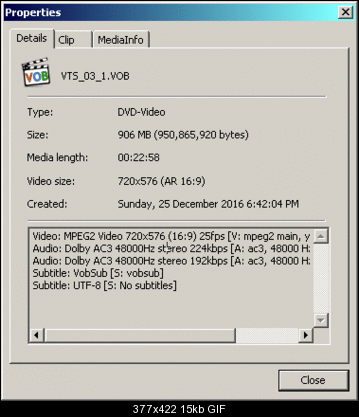

    This number just barked out at me right now, like never before, hadnt noticed it till now. Its now in my vocabulary, lol. (The PAR Ratio)Image
    [Attachment 39982 - Click to enlarge]
    Oh i get it, the raio of PAR is just the value thats calculated, its not a constant or a standard. I see. We have AR, which is (DAR), then we calculate teh "actual" resolution to get a PAR fraction, got it Slightly misinterpreted that in my last post.
    So what, now to look at this PAR, it tells us the pixel is not square? Its that simple? Thats the fraction of the pixel shape?
  6. PAR 64:45 is standard for 720x576 16:9 PAL DVD. Though it's only implied since DVD only specifies the frame size and DAR.

    the 6 preview was much higher rate, more power to CRF as it synced down on the fly!

  12. Originally Posted by wolfdogg View Post
    causing me to realize that if i had made that CRF come out at 1900kbps average it would seem to be a much larger video dataset
    Once again:
    file size = bitrate * running time
    Universally, No matter what the frame size, frame rate, codec, other setting, etc. There is a small amount of overhead for the container (typically a few percent for MP4 or MKV, 5 to 10 percent for transport streams) and of course, the audio adds to the size. But if two videos use the same container, same audio, are the same length, and MediaInfo reports the same bitrate, but the file size is different, then the bitrate report is wrong for one or both files.

  16. When Handbrake's finished encoding, you could always use it to open the encoded video, which then becomes the source..... just so you can get Handbrake to show you the encoded video's SAR. It might be easier than hunting through log files.
    Some encoder GUIs (and I've no idea if Handbrake is one of them) ignore the sample aspect ratio/display aspect ratio when the source resolution is 720x576 or 720x480 and fall back to their usual NTSC/PAL assumptions, at least when the pixel aspect ratio is close to the standard PAR for PAL or NTSC. Something to keep in mind, just in case.
    Most programs don't display a sample aspect ratio, but rather DAR as it's more intuitive. As a rule I check that sort of thing with MPC-HC and it's File/Properties menu. If no display aspect ratio is shown next to the resolution, the pixels are square.
    Any display aspect ratio shown as part of the video stream info should be quite accurate. Above the stream info, there's a display aspect ratio shown next to "video size", unless the pixels are square in which case once again no display aspect ratio is shown. The "video size" DAR is sometimes a little different to the DAR shown for the video stream. That's because the "video size" DAR is the "display size" without any further upscaling and therefore it has to be rounded to whole pixel dimensions.
    By default if both the video stream and container have aspect ratios specified and they're different, MPC-HC will use the container aspect ratio. Most players assume PAL or NTSC is exactly 16:9 or 4:3.
