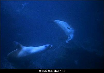

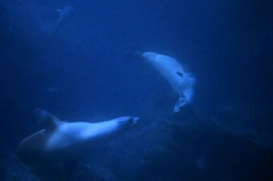

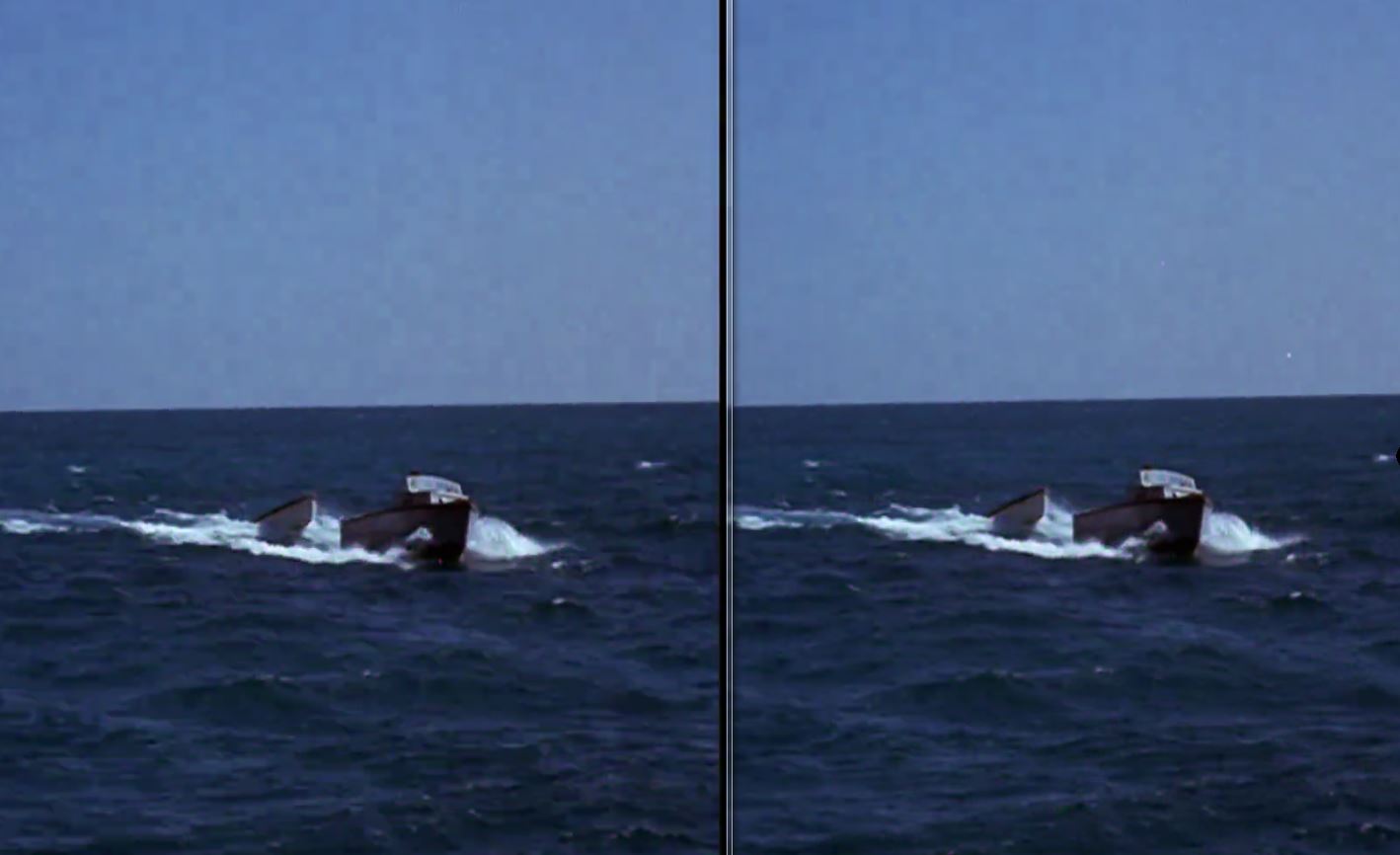

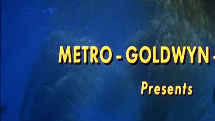

    I have a dvd source, flipper 1963, i want to re-compress it to H264 using vdub, i have x264 codec, leaving audio already AC3. I thought i would try for about ~1GB in size, then i thought maybe i could get the best quality by upping it to 1280px right off the top, using lanczos(not lknowing best for large resize like this) and im not happy with the CRF28-38 results at all. Should i leave the size as is, and transcode at "higher bitrate", or should i resize and trancsode at a slightly lesser rate than the "higher bitrate" mentioned.
    So when testing encodes, should i shoot for 1280 4x3 material, or leave it 720x576 and just take a higher bit rate, for best quality network playback on future hdtv monitors at the best 1963 quality? Note, this source quality is pretty nice, but im just not seeing that represented in this shot! Click image for larger version

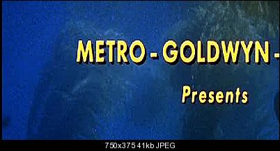

    Here is the CRF-28 compressed Click image for larger version
    Note, ill run a multipass once i get the basic figured out here.

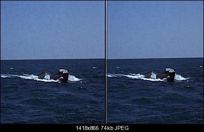

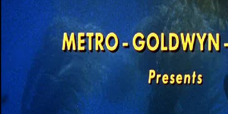

    I also managed to get the 720 vs 1280 comparison shot (its not the exact same frame), on a 3000kb multipass compression, heres the two, notice the huge white artifact spots in the sky on the 720px one on the right.Click image for larger version
  2. Why are you doing this? Why not just watch the movie and be done with it? If you want to add quality, that is a waste of time because you won't get any additional quality. If you want to upscale it so it displays at 720p or 1080p on a big display, use a DVD player that includes upscaling. These players do a fine job and take exactly zero effort: you just put the DVD into the player, and press the play button.
    Feel free to try different things, but when you are finished, if you compare the result to what I just suggested, my guess is that the results of your efforts will almost certainly look worse, and will definitely not look any better.
  3. Originally Posted by wolfdogg View Post
    im not happy with the CRF28-38 results[/ATTACH]
    Of course not. Try around 18.

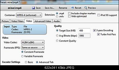

    I tried vidcoder, and im pretty satisfied with those results. at filesize it chose 1981kb/s and results look nice.
    for the record, CBR18 looked way over what 3000kb/s output on filesize, at least on my tests, for 25 mins video 2GB files, but i didnt look into the intracies really as to why. they nearly doubled using mostly default and auto settings it seemed.
    I took the suggestion not to upscale, so i just chose to go with a bitrate solution to achieve the file-size i wanted. There is one thing i was going to do, using vdub, thats run a unsharp mask on it, not sure how to do that yet on handbrake/vidcoder, but ill be playing with handbrake more often. Hmm, is there something inherently wrong with vdub, or does the standard vfw x264 codecs need tweaking before achieving those results?

  10. If anything, I tend to do the opposite. Instead of upscaling I downscale a little and encode at a higher quality. If there's a little loss of fine detail it's probably not something you'll be able to see without a direct comparison to the source, but compression artefacts are more obvious. For interlaced PAL, it's often possible to de-interlace and resize to 640x480 without any obvious loss of detail (at least when de-interlacing with QTGMC) but often even progressive PAL 4:3 DVDs don't have 720x576 worth of detail.
    Encoding at 720x576 is no doubt technically the best method as there's no resizing involved, but even resizing to 720x540 or 704x528 square pixel dimensions might be worth trying. I always encode after resizing to square pixel dimensions myself, although that's partly because a couple of the players in my house don't obey aspect ratios for MP4s or MKVs.

    This is extremely helpful info thanks much guys for the input.
    So, i gave up the upscaling idea, thanks for clarifying the terminology there.

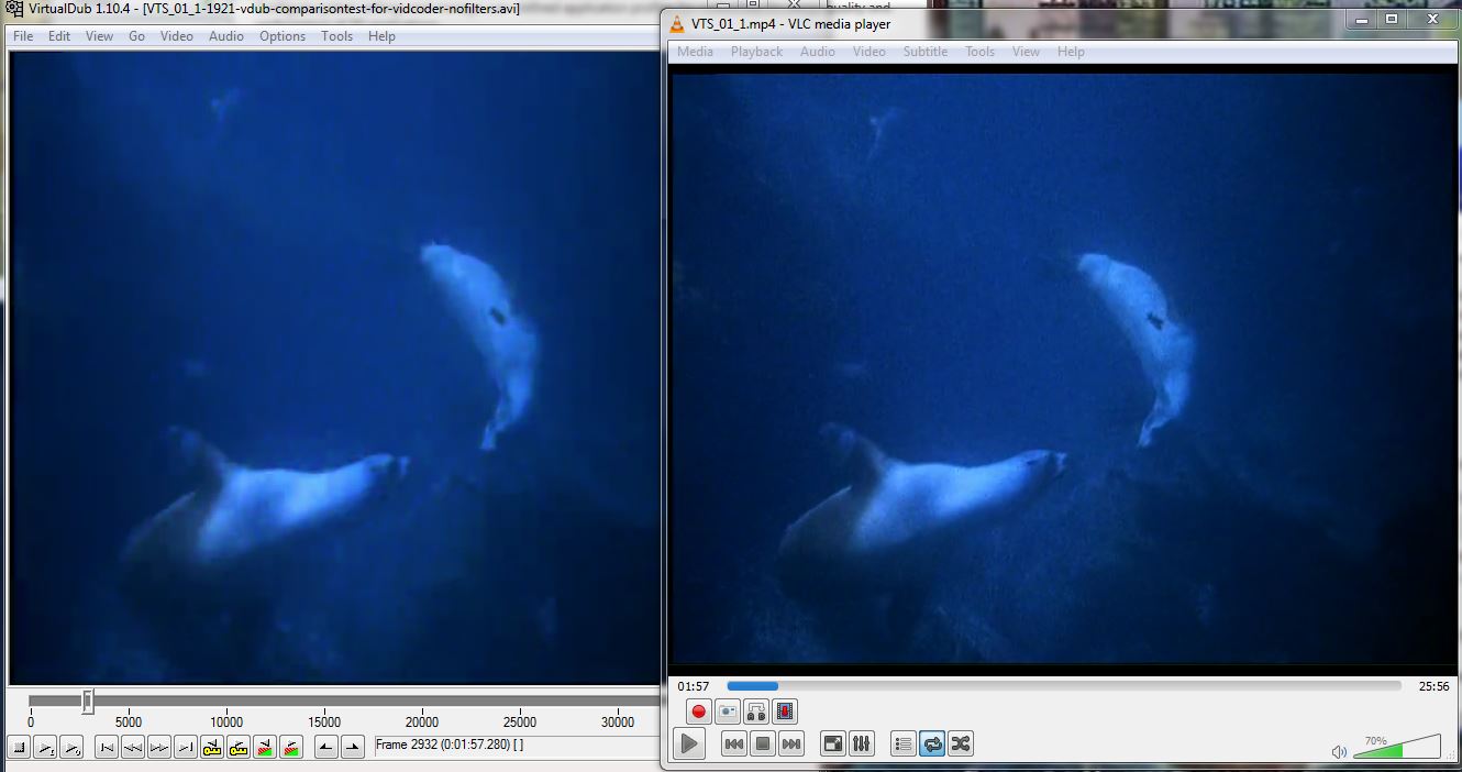

    I tried vidcoder vs. the bitrate that vidcoder said it was going to use (1921), and ran vdub at that rate (x264@1921) and the results are very different.
    So i think this is why i was asking why earlier how encoding through vdub encoder setting, the output could be so drastically different. However now that i think of it, there is those settings(placebo, fast, etc..) i guess that makes up a good part of it, however I used Medium Auto on vdub, and vidcoder compressed still very fast, maybe twice as fast as vdub, not sure but was maybe an hour or two for all 4 vobs. nice.
    So, look at the vidcoder video output (in vdub on the left) compared to the vlc output of vidcoder file (on the right, looks just as good in vlc) what gives?
Name:	1921 comparison.JPG

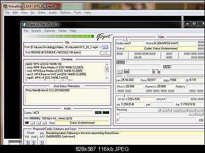

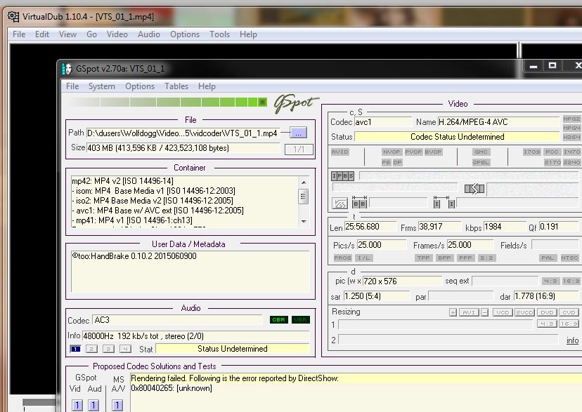

    I cant open the output file from vidcoder in gspot or vdub either, even though it looks cleaner, is this normal? Click image for larger version
Name:	cant open vdub.JPG

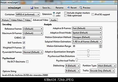

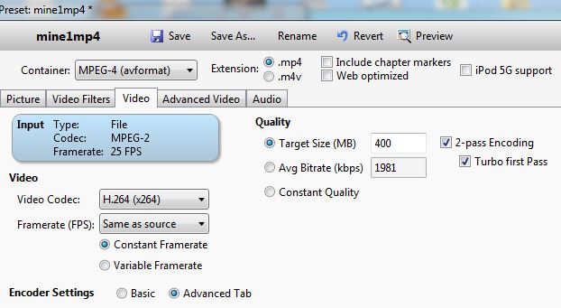

    I grabbed a shot of my vid coder settings here

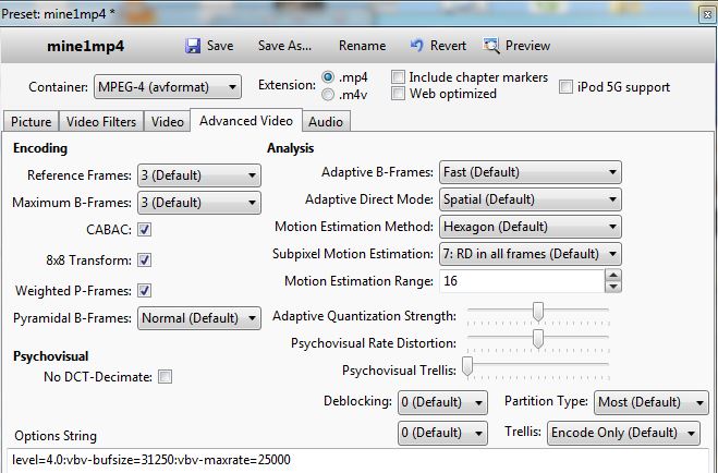

    and the advanced tab, all pretty much default
Name:	vidcoder-settings2-mostly default.JPG

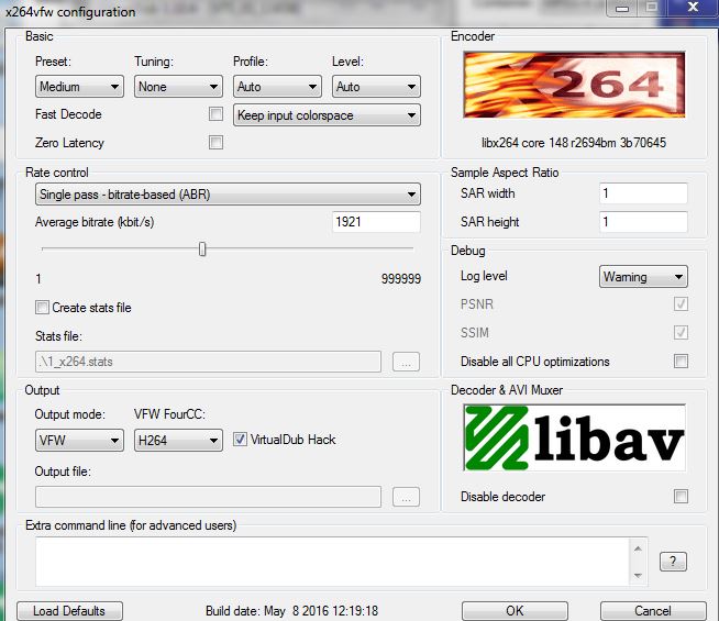

    I also just grabbed my vdub compression settings for comparison
Name:	vdub settings.JPG

  12. GSpot is pretty useless for mp4 or mkv files. Use MediaInfo instead. And when you encode with x264 the settings used are stored as metadata in the file. MediaInfo show you those settings. Compare MediaInfo reports of your Virtualdub and Vidcoder files to see what's different.

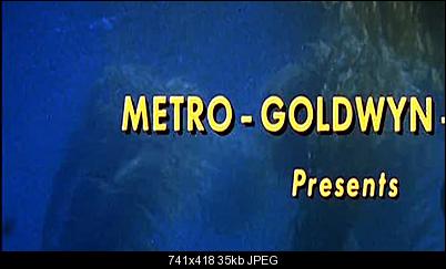

    So, my latest here, i got a pretty encoding using handbrake. heres the scene @1900kbps, high, 4.1, multipass, slower, no filters, loose anamporphic, 16mod, 720w, crop auto. Heres the mediainfo, and Superb, i JUST rememberd now i use to use this on linux for mpeg-2 compression, ok, heres the 'text' and accompanying screenshot
    here is the comparison stat of the virtualdub encoded file mentioned in early posts.
    ideo
    Format : AVC
    Format profile : High 4:4:4 Predictive@L3
    Format settings, CABAC : Yes
    Format settings, ReFrames : 4 frames
    Codec ID : H264
    Duration : 25 min 56 s
    Bit rate : 1 921 kb/s
    Width : 720 pixels
    Height : 576 pixels
    Display aspect ratio : 5:4
    Frame rate : 25.000 FPS
    Standard : PAL
    Color space : RGB
    Bit depth : 8 bits
    Scan type : Progressive
    Bits/(Pixel*Frame) : 0.185
    Stream size : 353 MiB (90%)
    Writing library : x264 core 148 r2694bm 3b70645
    Encoding settings : cabac=1 / ref=3 / deblock=1:0:0 / analyse=0x3:0x113 / me=hex / subme=7 / psy=1 / psy_rd=1.00:0.00 / mixed_ref=1 / me_range=16 / chroma_me=1 / trellis=1 / 8x8dct=1 / cqm=0 / deadzone=21,11 / fast_pskip=1 / chroma_qp_offset=-2 / threads=6 / lookahead_threads=1 / sliced_threads=0 / nr=0 / decimate=1 / interlaced=0 / bluray_compat=0 / constrained_intra=0 / bframes=3 / b_pyramid=2 / b_adapt=1 / b_bias=0 / direct=1 / weightb=1 / open_gop=0 / weightp=2 / keyint=250 / keyint_min=25 / scenecut=40 / intra_refresh=0 / rc_lookahead=40 / rc=abr / mbtree=1 / bitrate=1921 / ratetol=1.0 / qcomp=0.60 / qpmin=0 / qpmax=69 / qpstep=4 / ip_ratio=1.40 / aq=1:1.00
    Color range : Full
    Matrix coefficients : RGB
    Major difference in setting in this initial vdub one, i see it used 'hex' too.
    As far as the AR, thats kind of unwieldly for me, i want a clean 4x3, so it self maximizes avoiding the fricken double black border (top/bottom and also left/right), which is unacceptable, and happening. not sure if i need to force it 4x3 or what.
    Here is a comparison of the setting differences (in vdub parameter format, since im going to test compare using the HB parameters in vdub to see if i find comparable results.
    vdub (an abr pass)
    --ref 3
    --me hex
    --subme 7
    --b_adapt 1
    --b_bias 0
    --direct 1
    --rc_lookahead 40
    --rc abr
    HB (a multipass, and notice several new params here also)
    --ref 5
    --me umh
    --subme 8
    --b_adapt 2
    --direct 3
    --rc_lookahead 50
    --rc 2pass
    --cplxblur 20.0
    --qblur 0.5
    --vbv_maxrate 62500
    --vbv_bufsize 78125
    --nal_hrd none
    --filler 0
    going to try these latter params in vdub momentarily.
    Edit: tried, alot of these params wont work in vdub, ill use cli or handbrake next time, consier a bat file, but ill like use linux before i use a bat. So i think i have a system here. Im happy with Handbrake (thanks to vidcoder test), and this is my scenario. Any last suggestiong im open to, and maybe i can stick with my last encodes as my finals it looks like.

  18. Again, stop using ABR. Use 2-pass VBR.
  19. Member wolfdogg's Avatar
    May 2011
    Portland, OR, USA
    Yeah i use 2pass only, as i mentioned, that was just the 'mediainfo' from the previous post virtualdub copy. by no means do i have any, or given any, intentions to do otherwise, for sure. So 2pass is vbr, whoa. im a big anti-Variable guy, you might have changed my mind, but i have alot of video problems in the past using variable encoding, althought that may mostly be variable audio(different topic i know)
  20. Member wolfdogg's Avatar
    May 2011
    Portland, OR, USA
