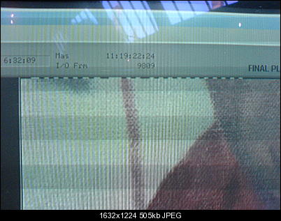

  6. Half line in PAL are not blanked and this is clearly visible in first half of line 23 - first half of this line carry WSS signaling which belongs normally to VBI signal (normally not visible) however in video codec this part of video (out of active video) is encoded as regular video data - it is common to see WSS stripes in many PAL captures.
