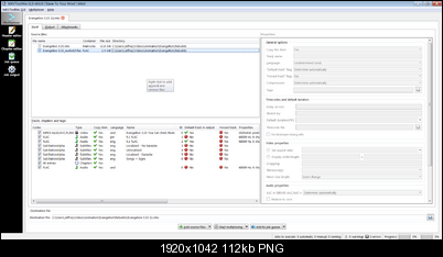

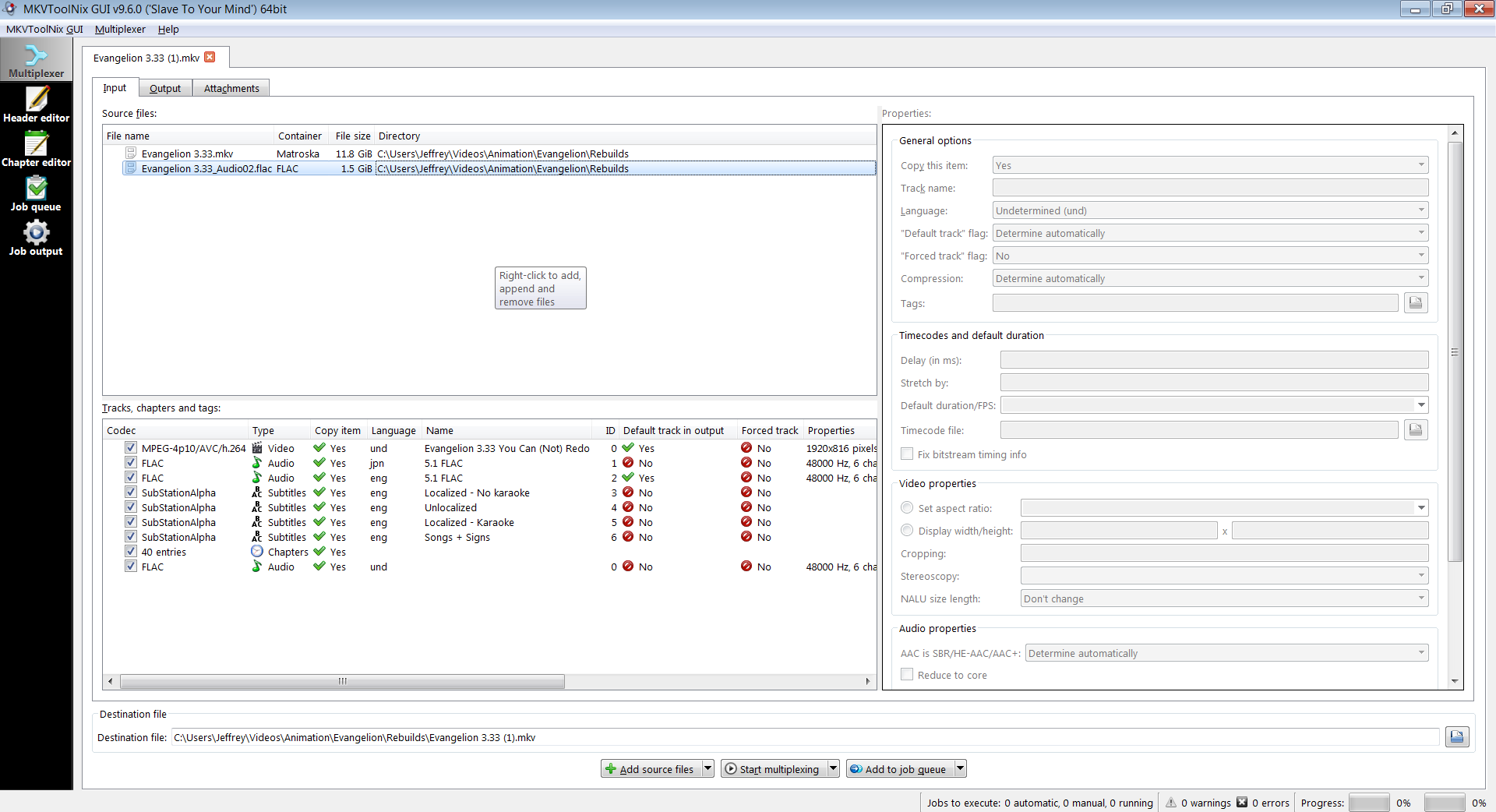

    I extracted the audio timecodes from the video, but I can`t quite find where in MKVtoolnix I would re-insert them. There is a section labeled "timecodes", but everything in it is grey and inaccessible (see image). Am I looking in the wrong spot?
Name:	Screenshot 2016-12-25 12.01.51(2).png

  12. You'd need to select the audio stream in question in the bottom left pane first, so MKVToolNix knows which stream the timecodes belong to.
    Dec 2016
    Muxed the audio with the timecodes extracted from the original file. Still stretched. Did not otherwise edit the extracted track in any way.
