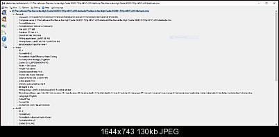

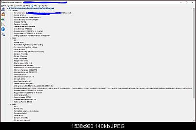

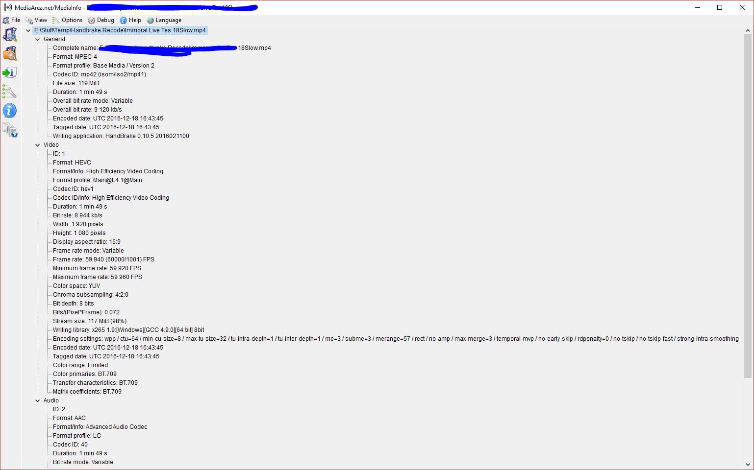

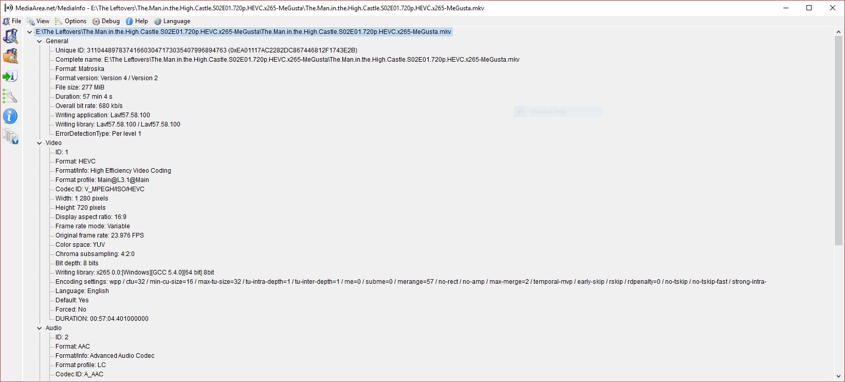

    Allright, after extensive testing I am happy with the quality but I can't seem to be able to bring down the file size. Take a look at the Mediainfo for both files :

    My test, which something I shot is 1080p 60fps, 1:50, and at a QBR of 18 and the encoding speed set to slow speed it still gives me a file size of 125mb.
    Compare that to the tv episode of 57 minute with a filesize of 277mb, and for that size the quality is astonishing.
    Granted the episode is 720 and not 1080 but it shouldn't make that much a of a differencr, right?
    Do I use the wrong settings? Am I using the right encoder (handbrake)?

  12. Originally Posted by philvideofilm View Post
    Wrong. 1920x1080 is over twice as many pixels as 1280x720 so it will take more bitrate. And your 1080p source is 60 fps, not 24 fps. So that will require more bitrate too. And your handheld, noisy, camcorder video probably won't compress as well as professionally shot film.
