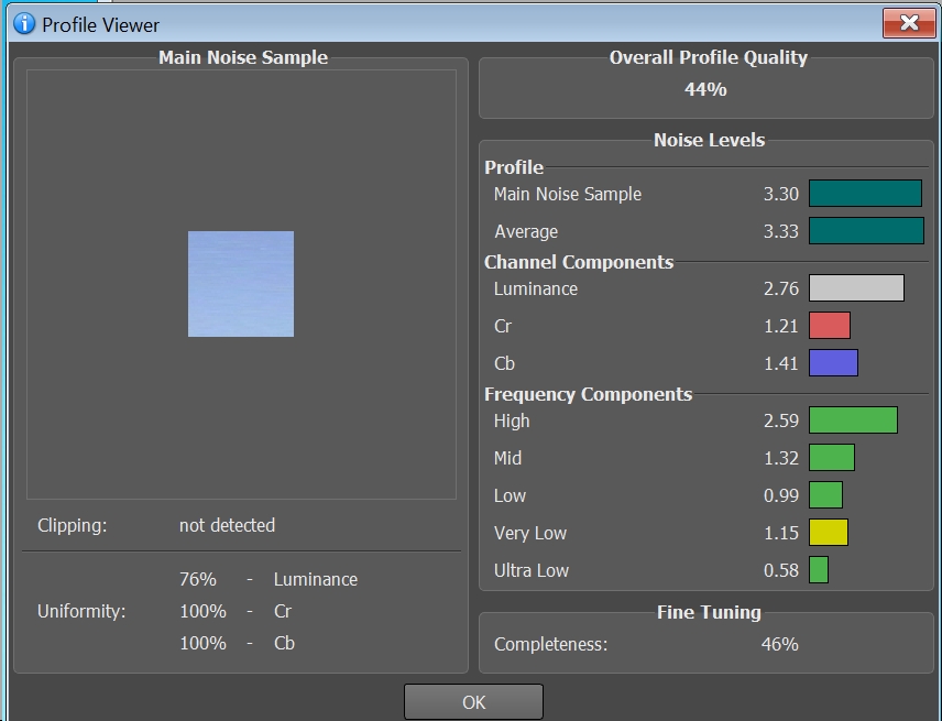

    attached - noise profile sample

    Hoping to have your comments, reviews about this script to try to improve and optimize it if possible and to solve some of the remaining problems
