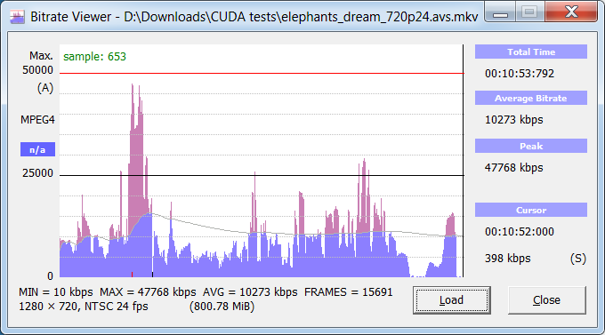

MediaInfo is useless for this. It doesn't parse the actual video stream, just reports what's in the header. Use Bitrate Viewer. It will show you a graph of the bitrate over the entire file. And it will report the true average and peak bitrates. For example:
[Attachment 40140 - Click to enlarge]
That video has an average bitrate of about 10 Mb/s but there are peaks over 40 Mb/s.Last edited by jagabo; 2nd Jan 2017 at 11:50.
True, but correctly interpreting the Bitrate Viewer results is not trivial. You can have a lot of high spikes but that doesn't imply any playback problem or spec violation. To see spec violations you need a buffer verifier (vbv).
